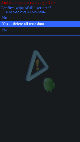

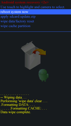

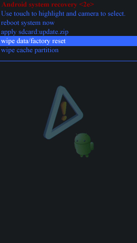

Hard Resetting the device usually can resolve the device when a update fails.. Follow instructions from http://support.verizonwireless.com/clc/devices/knowledge_base.html?id=33552
Android version 2.3 (Gingerbread)
- Power the device off.
Press and hold the Power button then select Power off.
If the device isn't responding to input, remove / replace the battery. - Press and hold the Home key then power the device on.
Press the Power button while holding Home.
- From the Android Recovery screen, press Volume Up / Down simultaneously.
- Press Volume Down to select wipe data / factory reset then press the Power button.
- Press Volume Down to select Yes -- delete all user data then press the Power button.
Reset process to may take approximately 1 minute.
- Using the Volume Down key, ensure reboot system now is selected then press the Power button.
- Refer to Initial Activation and Setup.
