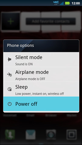

Power Cycle your Bionic and Do this pyrokat Go to your Browser and tap Settings then Tap More Tap settings again When get to Settings there will be a white Paige) with settings on it Scroll the page up till you find Privacy Settings and Clear all this clears all of your Browser History when that is done Tap home Then perform the Soft Rest..
Here is how to perform the soft reset.. Give these a Try and see if it help the issues your Having Good Luck b33
Here's How to perform a Soft Reset For your Bionic : b33
Soft Reset - DROID BIONIC by Motorola
A soft reset is the most useful tool for resolving a variety of issues. In most cases, a soft reset will not affect data on the device, unless the battery is very low.
If the device doesn't respond to input, remove then re-insert the battery.
- Press and hold the Power button.
- Select Power off.
- Press and hold the Power button to power the device on.
