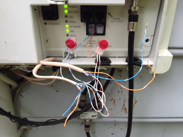

Seems that this should be easy... I just added a second phone line. I cannot figure out how the lines at the ONT are supposed to be connected at the ONT. right now, both phone lines come to the ONT , Both White lines are linked with a clear/red plastic caps and then one orange and one blue connect them to the T and R in the ONT. That leaves the orange and blue from BOTH phone lines unconnected to anything... Am I supposed to go buy the clear/red plastic caps to link both Orange and Blue together before inserting into the T and R on the second ONT location? can someone tell me what to do here? Thanks in advance

Technically they normally consider anything past the Ont on the home owners side as inside the house.
Rather surprised at the odd phone wiring shown. Is the line 1 already handling a two line phone? Most phone wiring these days is ended with a simple moduler plug (rj11). This is then plugged into the line 2 possition at the ONT if each phone is a single line.

SO according to the Local Manager /FiOS technician, their job stops at the ONT and Verizon would NOT be required to attach the phone lines since that is not regulated... I can have the choice of vendors do this part, or do it myself...
Here is the Managers answer re: wiring configuration:
