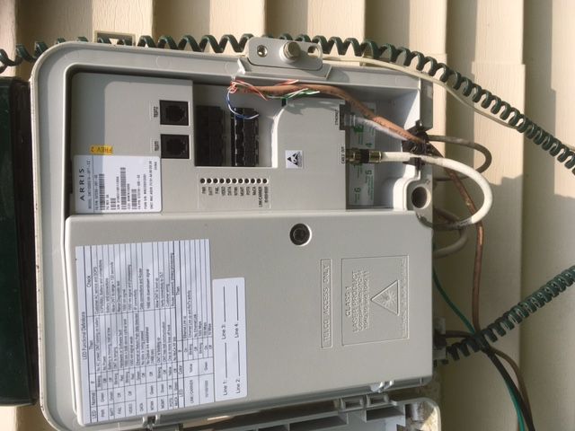

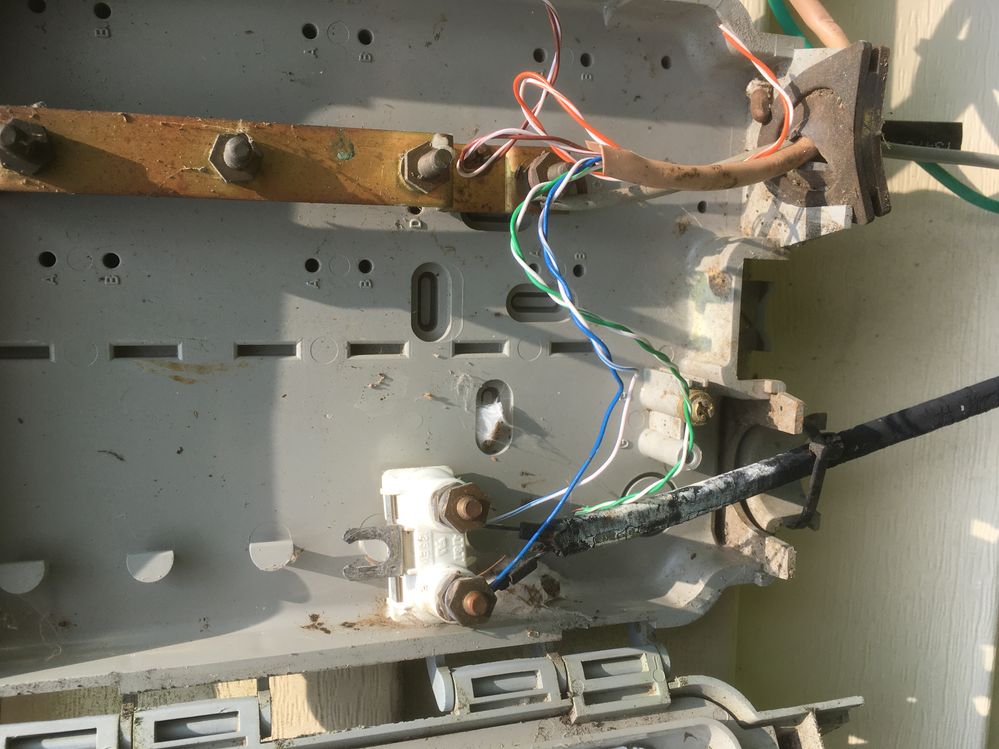

Also, the tip/ring wires(blue and white connect the ONT to the NIDNID box
ONT

Ah...that is an older ONT as opposed to the current Alcatel-Lucent (Nokia) 211.
The picture of the ONT looks unusual in that none of the status LEDS appear to be illuminated. That would indicate that the unit isn't in use.
The wiring inside the ONT enclosure looks OK to me. The wiring in the old NID is a bit hard to follow, and there appears to be some corrosion (surface level anyway).
Based on visuals, the ONT looks clean. The old NID looks a bit suspect.
The original post where dialtone is always found at the ONT rules out a problem with the ONT itself unless one of the BL/WH conductors has a break inside the insulation.
If you feel comfortable working with the bl/wh pair, it should be easy to snip off the ends of each wire at the ONT end and re-insert them into the clip.
There is always the possibility that there is an intermittent issue with the ONT, but Verizon can check the ONT's error logs.

There are led status lights lit but are hard to see in sunlight. Green PWR, Amber Link/Carrier.
Not sure of any others. The NID box is from the original copper POTS ca.1977 install from NJ BELL😁

Simple fix, the tech just removed all the wiring in the NID and attached the tip/ring wires from the ONT to a new terminal block in the NID. 15 min. Job. see below:
NID reconfigured

The inside of the NID looks much emptier now..
The old cable that the blue/white pair is on top of looks pretty worn. If it goes inside to another terminal block, it might be a candidate for replacement...but that is down the road.
