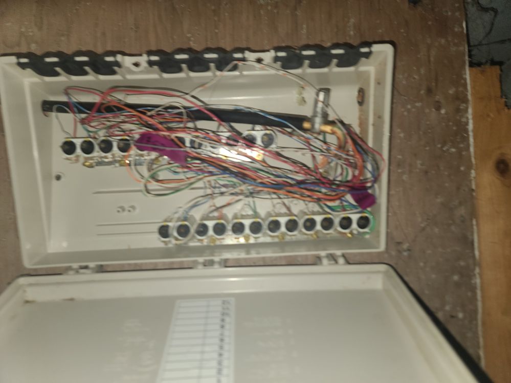

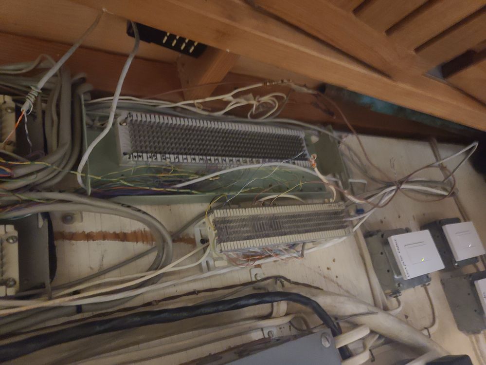

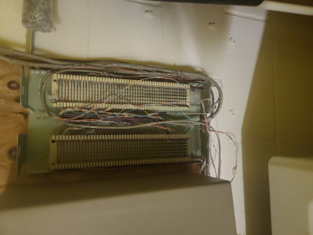

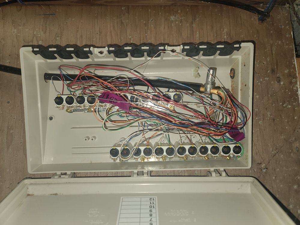

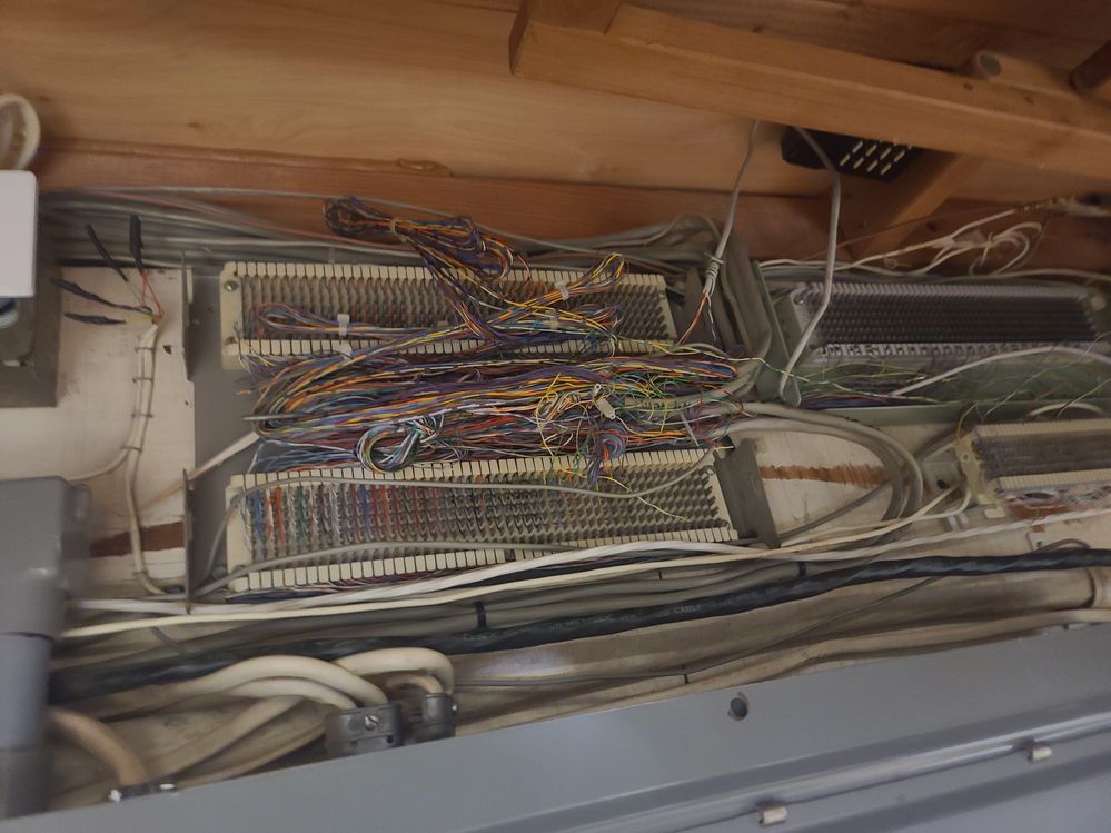

I don't know the system. Where should I look? I have some photos. It's all copper with several junction boxes and wires punched down on the board.
And the goal is just to get the phone controlled gate working, and for the phones to work. Some do.
If Verizon could fix lines in the house, I'd keep POTS. But if the alarm and gate could work with fiber, then the goal would be fiber.
-A

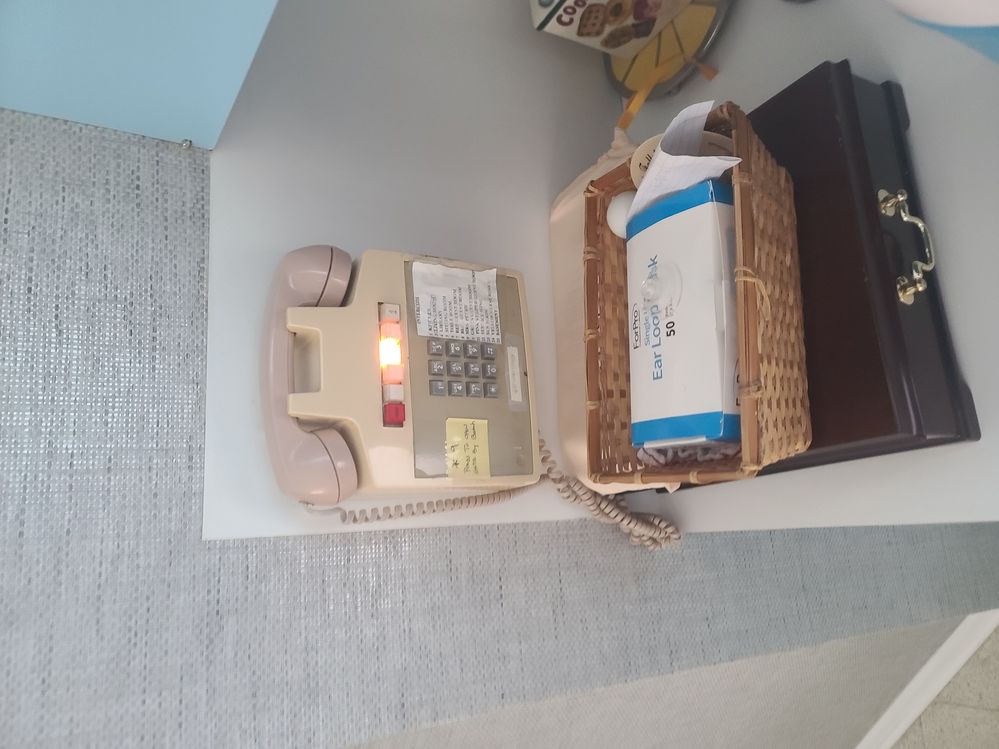

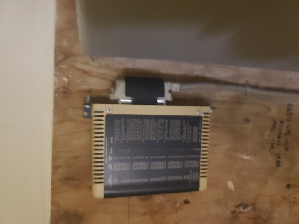

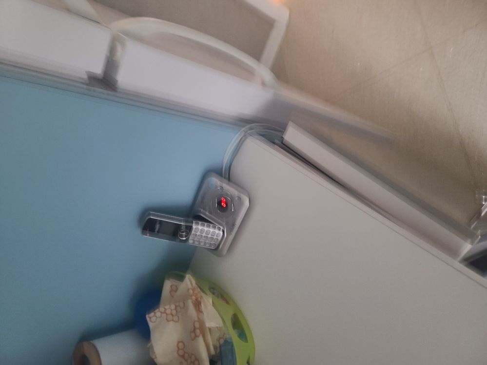

A picture of a telephone set and of the telephone system controller should help. Note that submitted pictures are queued for Moderator approval before they appear.
Note that Verizon doesn't typically work on inside wiring that is associated with telephone systems. Wiring and hardware issues are addressed by an Interconnect, which falls outside the scope of these forums.
The two URLs I posted are for message boards where telephone system related questions can be asked and answered.
As noted above, post pictures and we'll attempt to identify the system. 🙂

Hello again,
I have some pictures for you. I am not sure if the telephone system controller is included though. You tell me if it is.

A 1A2 key system! 😲
FiOS would work with a 1A2, but the system doesn't support Caller ID. If Optimum can provide POTS telephone service, the 1A2 can go forward. If the system is to be replaced, consider putting all of the hardware up for sale as some telecom aficionados collect and install such systems in their homes. 🙂
Oh, the controller for the telephone system should be to the left of the block seen in the second picture.
