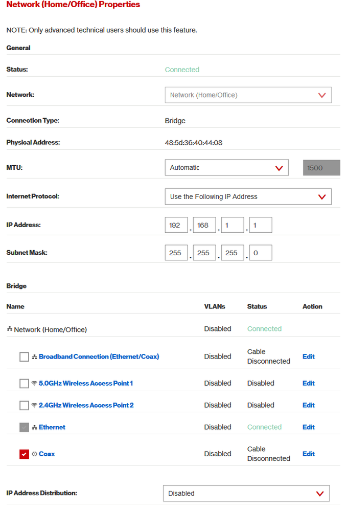

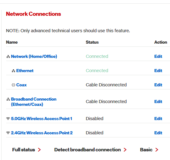

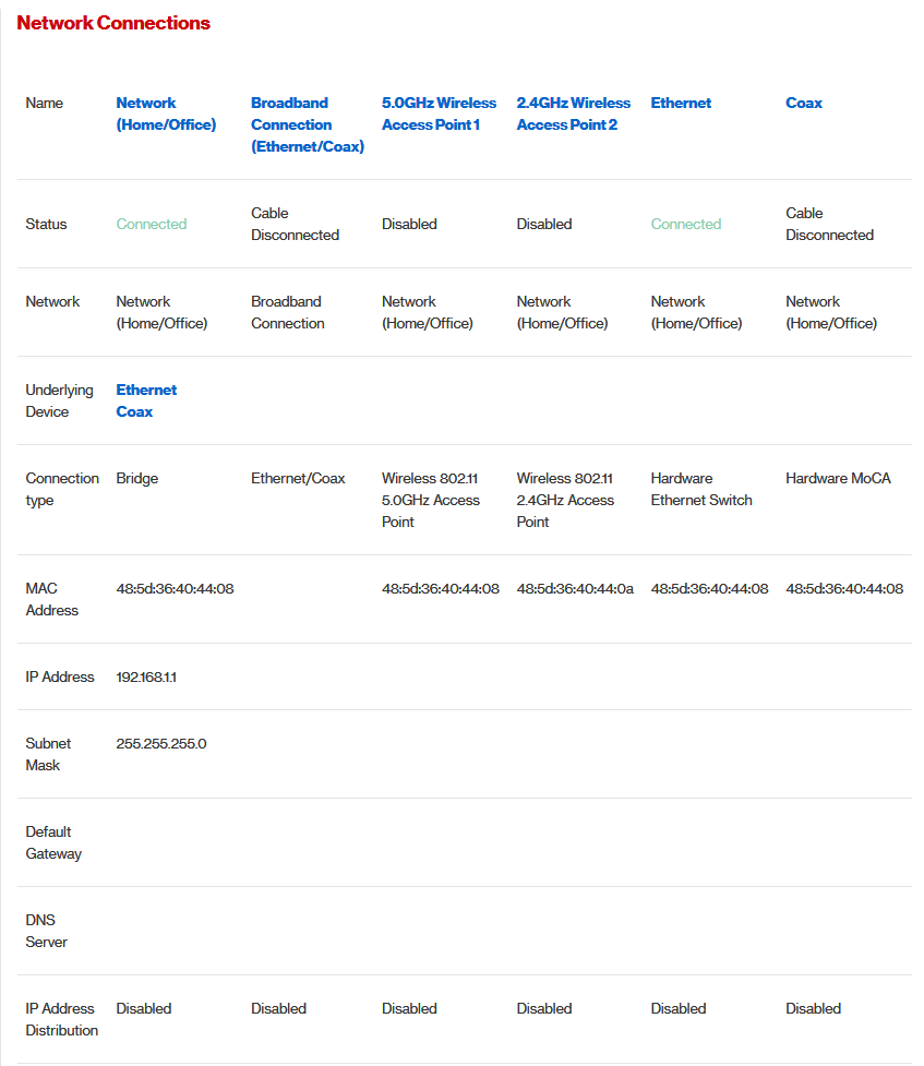

happy FridayHappy Friday! Having some issues getting my Alexa to control my Fios boxes. She will repeat back to you as if she did change the channel but the channel doesn't change. I'm also not getting my caller ID to TV but everything else seems okay. I recently upgraded to the Fios One service. I attached some screenshots of how I have the quantum gateway configured. I'm sure I have something incorrect in their.

Working to set up bypassing the quantum gateway and I was wondering if someone knew what ports have to be forwarded in order to get the caller ID to TV to function properly and also the Alexa voice control. Any help would be greatly appreciated.

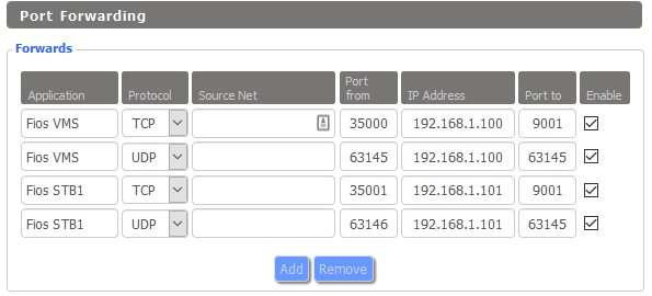

I also meant to include my port forwarding setup because I don't know if I have it done properly
