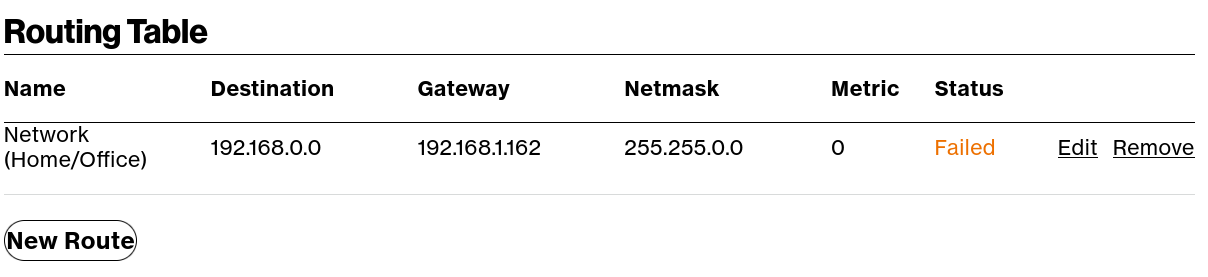

I added a route to my raspberry pi, which is at 192.168.1.162.  When I ping through the route, it works, but it works like this:

Clearly the next hop's byte ordering is reversed.  The route was entered correctly:
Well, the static route was allegedly entered correctly. You are telling  it to route 192.168.0.0/16 via 192.168.1.182. The gateway address should not be in the same subnet as the destination subnet.
