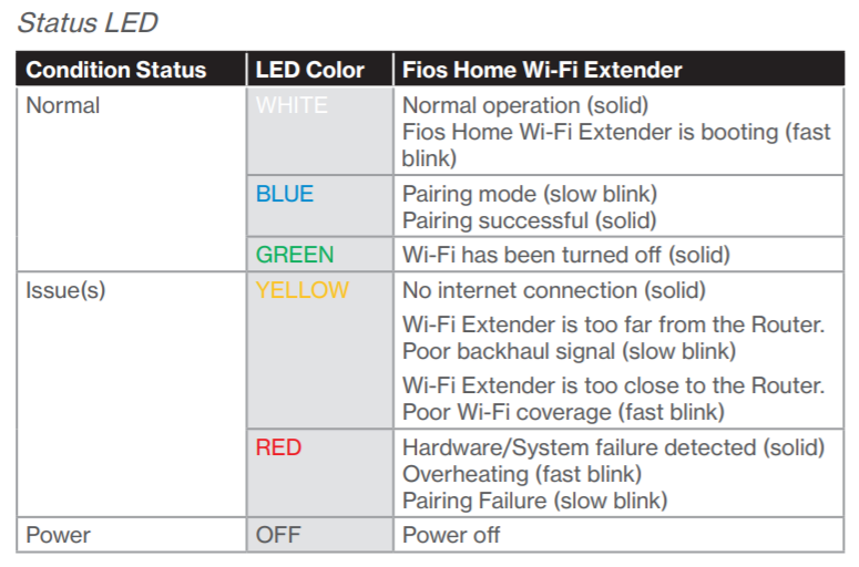

The E3200 is uplinked to G3100 right?
Here is the description for LEDs. I believe the yellow blinking occurs only when you turned on the meshed WiFi.

This is working as expected. After all you list, unplug and move the extender to another room at least 20 feet away from the primary router. Don’t mess with the primary router.
plug in the extended and wait about 10 minutes.
they don’t tell you this in the dumb setup guide.
what happens is the two routers are smarter than you think. It knows if it is too close in proximity to each other, probably to prevent cross-talk.
This took me some research to figure out.
I hope it helps, it is anti-intuitive.
