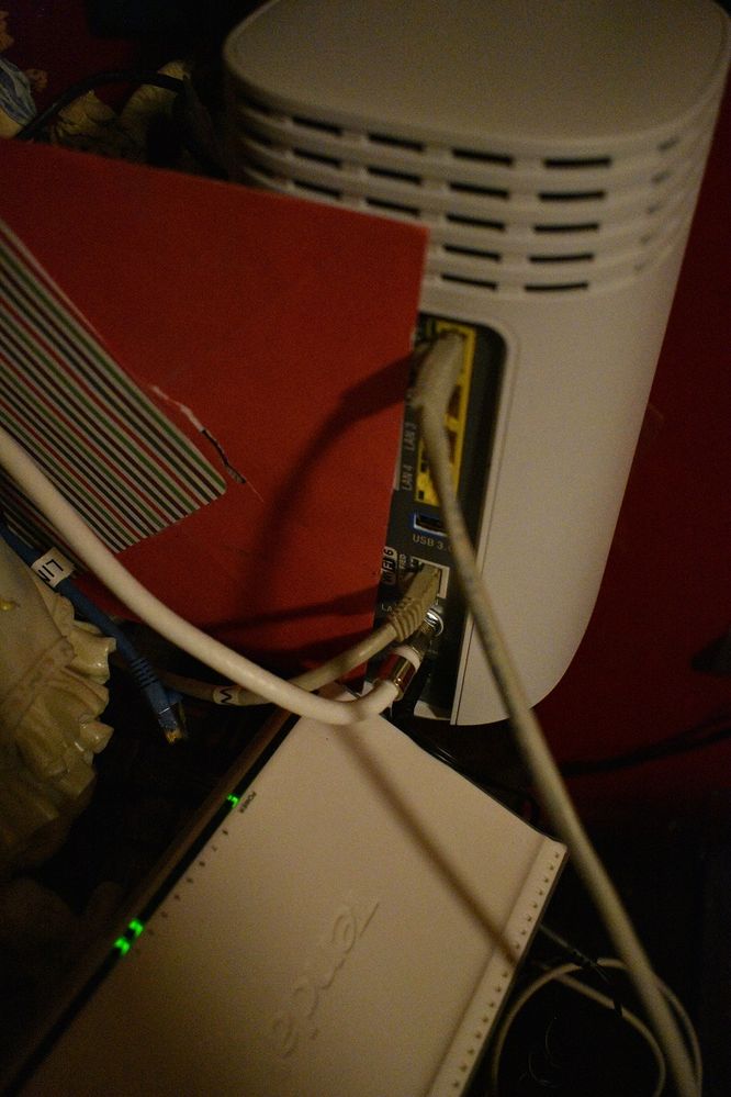

Did you connect the switch in the following fashion?
Leave WAN cable from ONT to G3100 WAN alone. Connect an Ethernet cable from G3100 LAN port to the switch, then Ethernet to computer from the switch.
Also, pictures of your setup would help.

Okay, so far on connections. I believe I tried yesterday without success.
Now, it appears taking an Ethernet cable into G3100 LAN port (#1) into Tenda Gigabit 8-switch and then cable to computer, I see flickering action on switch and internet access. However, if I try other Ethernet cables, (those with switches at the end (also see statement below regarding storm) no connection.
Wondering if all cables went bad. My OOMA VOIP unit still not connecting to internet.
Called tech support at OOMA having me doing all that I've previously done without any success.
He said may be to old (Telo unit). Yet, it appears to be functioning but unable to connect.

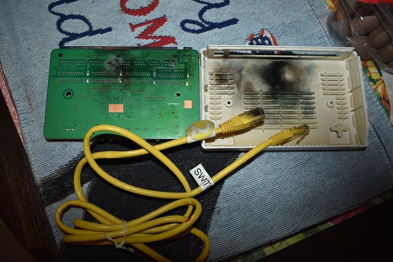

Let me point out one situation from a couple days ago. A lightning storm hit our area close to the house.
I found out the internet was out. Went to check the G1100 for analysis. I found the G1100 unable to turn on.
At the same time near the G1100 I found my 5-port switch damaged. That is, burn marks on body and inside including a Ethernet cable scorched at the end. That's why I went out purchasing an updated router with extender (G3100/E3200). Is it conceivable cabling went bad ? I have 50ft Ethernet cables running upstairs, downstairs and so on (all separate). Could the lightning strike fused, rendered the Ethernet cables bad ? At each end of the cables are switches to various components (PS4/Xbox/etc) and others to upstairs computer. I did check all components out having no damages running without problems. However, no internet access for streaming, updates, etc. Let me know your opinions.

@NetLord wrote:Let me point out one situation from a couple days ago. A lightning storm hit our area close to the house.
You let me think of a video made by the 8-Bit Guy on Youtube.
You can take a look at this clip. In that video, the lightening fries the cables, connectors, hubs, and network interface cards.
https://www.youtube.com/watch?v=Ev0PL892zSE
Could you take a photo of your Ethernet RJ45 connectors?

Submitting picture of switch with cable used to G1100. Thanks on YouTube clip.
Went ahead couple mins ago purchasing at Monoprice Cat 6 cables of different lengths.
Pretty much to cover distance from the G3100 to upstairs and downstairs. In turn, I will bring each switch to my G3100 checking (same way as now) seeing if there's a connection. Obviously, if not working I will replace switches. I have a feeling it mostly cable related. I enhanced the power strip to clip spikes and so on.
Computers, game consoles and so on are functioning okay.
Will inform all of you if my other switches are working hooking to G3100 and computer to switch.

Yikes! 😳

It could be the conductors and insulations in the cable melted due to high voltage and current.

I would not be surprised if the switches and cables all went bad. Please post your findings once testing is complete.

Okay, here's the scoop. Went ahead checking each Ethernet cable in the network. Some not working and others okay. Found two gigabit switches not turning on. The rest of the system came out okay.
Waiting for Monoprice Ethernet cables to arrive. Delivery supposed to have been past Friday.
Keeping me from putting things back once where belonged. In the end, lightning made upgrade my router to latest "Verizon" version and reduced quite a bit of cables not necessary. All streamlined going from equipment to switch. Pretty happy about set up but time consuming and costing quite a few dollars.
I appreciate all of you that have responded. Should have it clearer a lightning may have been a reason.
Thanks again!
