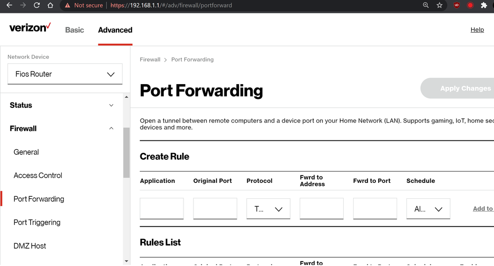

Port forwarding seems to mostly work in upnp IGD or dmz host (which I've turned on momentarily just to test this issue), but the entire advanced settings firewall port forwarding page of the settings menu has no functionality from what I've seen. I cannot get any port to register as open, no matter what I try. I could be doing it wrong, but given that I haven't found any instructions anywhere that work? Yet I have found many threads saying it doesn't work? I'm sort of just assuming it's broken.
I'd like to be able to get https://www.yougetsignal.com/tools/open-ports/ to tell me a port is open.
I had it working just fine on my g1100, and if you offered me a swap my old g1100 for my new g3100 right this second I'd take it. (It's not that simple though since I changed plans and the rental of the new router is free due to a promotion.)
It's quite possible I'm doing something wrong but I'd like to use the below page to enter some choices that result in an open port in a port open test tool like https://www.yougetsignal.com/tools/open-ports/
The problem is either a flaw/bug or a setting on another page that needs to be changed. But I have tried all manner of things from changing the firewall's general security setting, to disabling upnp, to well really anything I can think of.

On the port forwarding page, fill out all the boxes.
Application: a name for your port forwarding entry.
Original Port: WAN-facing port to be opened on router.
Protocol: TCP, UDP, or both.
Fwrd to Address: internal server address.
Fwrd to Port: listening port on the internal server.
Schedule: All time or create your own schedules.

Again, could you screenshot your Port Forwarding page to see?
Choosing ports other than 80 works. I have personally tested this in my mini Fios lab.
