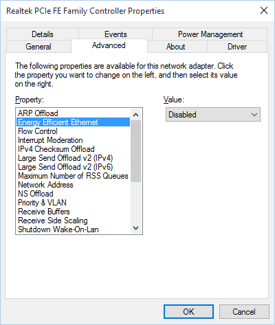

Problem: After getting FIOS installed with 50/50 service and the Gateway G110 router, I noticed that my hardwired connected PC kept dropping the network connection.  It kept happening randomly and at a frequency that ranged from every few seconds to a few minutes.  My wireless devices had no problems at all.  This was a problem because for me to connect to my work, I required a stable connection since it would detect the drop and disconnect me (frustrating).  I tried plugging in to different ports on the back, but same experience.

- My PC (HP) uses the Realtek PCIe Family Controller for its NIC - I tried to update the driver but Windows 10 told me it was the latest.  Went to their website and found there was a slightly newer one for Windows 10 and so I force upgraded it.  I got an error message, but the driver version did update.  Technically at this point, I was still experiencing the same issues.  But I think this was part of the solution - see below for the latest Win10 driver version (as of 11/14/15)
- Found on another forum somewhere else to try turning off the energy saver.  That didn't make any sense since this was happening to my PC while it was still on and not from returning from SLEEP mode.  But I tried it anyway.  See screenshot blow where I turned the "Energy Efficient Ethernet" setting to "disabled"
And VOILA!  No more dropped connections.  I might have restarted after this too, but yeah, it worked after this.  Steady connection since.  YMMV - good luck to you!

Hey! I wanted to reply because this worked for me too. Just got FiOS installed and was having the same problem. Used your solution and it worked! Contacted Verizon by phone to tell them what you did. Nice going and thanks for your help.

I just wanted to express my sincere thanks to you for posting this. I had the exact same issue. Verizon replaced my ONT, router and power supply and the problem still existed. But after following your steps, everything has worked great! THANK YOU, THANK YOU, THANK YOU!!!!!!!!!!
