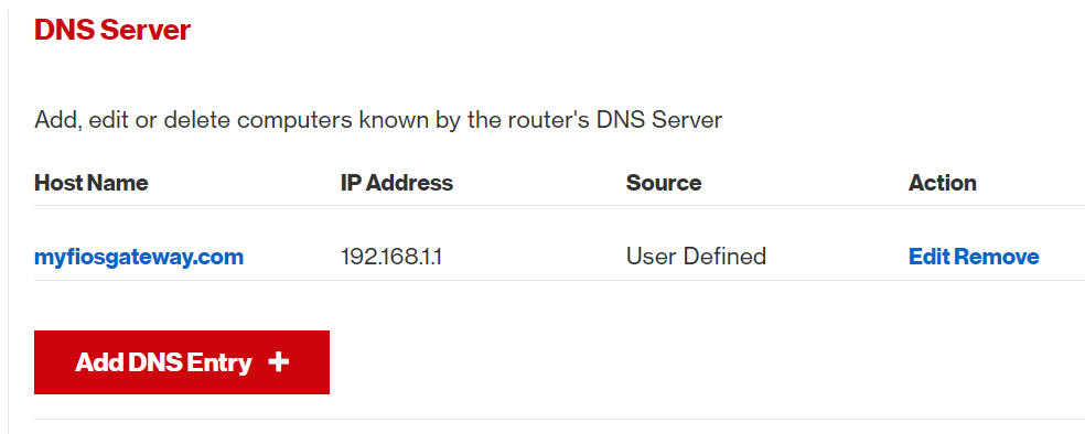

It seems that the Glasswire is mapping the Domain Name myfiosgateway.com to your router's IP address. Did you ever accessed your router's GUI through myfiosgateway.com? If you did, this may be saved in your DNS cache. Glasswire probably reads your DNS cache.
Is your router still reachable by myfiosgateway.com?
Do you have this entry under your router's Advanced > DNS server? I suspect you do.

I accessed the Advanced DNS entry and it only shows one entry - 'my PC name 192.168.1.151 DHCP'.
