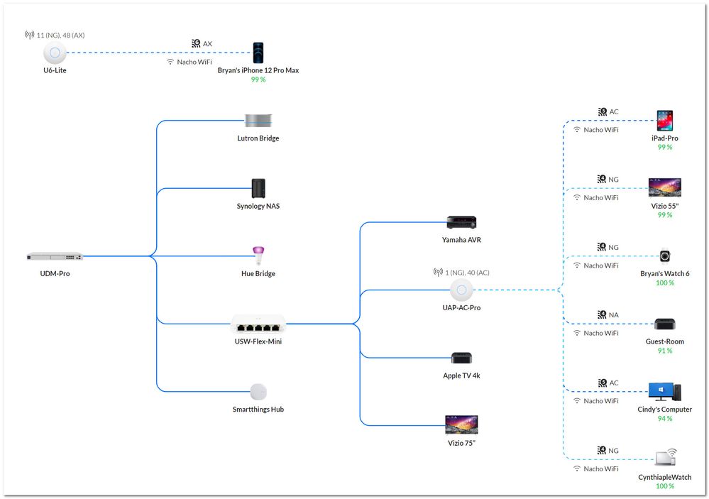

- On the rack is a Unifi AP 6-lite (wifi 2.4/5GHz)
- Cat6 from UDM-Pro to a Unifi Mini switch out to various wired clients and another AP on the opposite side of the drywall from rack. (AVR, TV, AppleTV, etc)
The UDM-Pro and the AP see the internet. I see clients connected to them and those clients also see the internet.....btw with significantly faster speed then via the G1100 radios.
