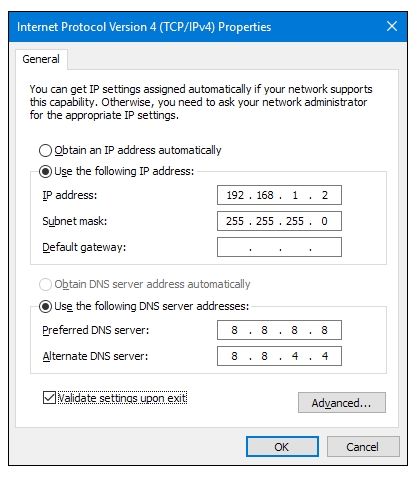

I have an Android app on a device, which I am using to connect to a shared folder on my PC. I want to use its SMB protocol to reach my home wireless network.
It works, but then the IPv4 address keeps changing. I have tried setting up a ‘permanent’ address in my Windows 7 settings, but then my PC won’t connect to the Internet at all. At one point, I also tried to adjust my router, but that also wouldn’t allow me to connect to the web afterwards. How can I fix this and set up a 'locked' address?

If you cannot access the Internet after setting up a static IP on the computer, then you probably typed a wrong address or forget to type in the default gateway.

Sorry for the delay in getting back to you all. I think I've solved my problem. In reviewing your replies, I went back and reviewed the situation again.
I am attempting to access my PC from an Android device that is also connected to my network on a 'live' basis. I sometimes using Google Drive and OneDrive, but they wouldn't work in this instance.
I had been using a setup I found on the web (see below) feeding in info obtained by an IPCONFIG command. It resulted in 'No Internet Access'. I tried it again and added in the Default Gateway address that was omitted. I was now able to connect.

If you hardcoded the IP address on the PC and didn't put it in a non-DHCP pool on the router, things will break when the router decides to hand that IP address out to another device.
