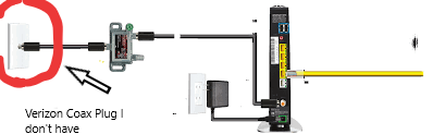

Hello I just bought fios (Internet only, not phone nor TV cable) and when I ordered the service through the web site I choosed the option to use my own router (because I already have the verizon router, I boutht it from a friend and it is the exacly same souter that they sell in the website) but there are some questions that I have.
I have never had any service from verizon in my house before (And the only thing that they sent was a package with some instructions on how to set up the router, they didn't install anything in my hose. Shoudn't they install an ONT or something?. In the instructions that they sent there is a step where I have to conect the Router to a verizon coax plug in the wall trhough a coax cable (in my house there are some coax cables in every room, but I'm not sure if I can conect the router to any of those cables or if it has to be a specific verizon coax plug.).
Has anyone installed Fios in the house without an ONT?.
