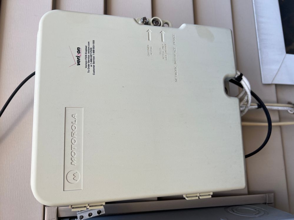

Replaced the Ethernet cable from router to wall, no change. Attached pic of the ONT. Noticed that we lost wifi in Master Bedroom on second floor, extender went yellow. By time I was able to get to basement router light was white (normal). Restarted MB extender and it was fine. Waiting for extender to restart, iPad picked up wifi from probably first floor extender and was able to go out to internet. Waiting on terminators, one open port on MOCA splitter. What else can I try?

Sorry for the delay in replying back. ☹️
Did Verizon replace the "guts" of the ONT with the Alcatel-Lucent (Nokia) 211 or is the Motorola ONT still inside?
It looks like there are multiple coaxial cables coming out of the bottom of the enclosure. Is there a splitter inside of it? Usually there is a single "F" connector on the various ONTs.

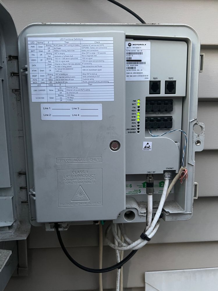

Here are pics of inside of box as well as the system log. Thanks!

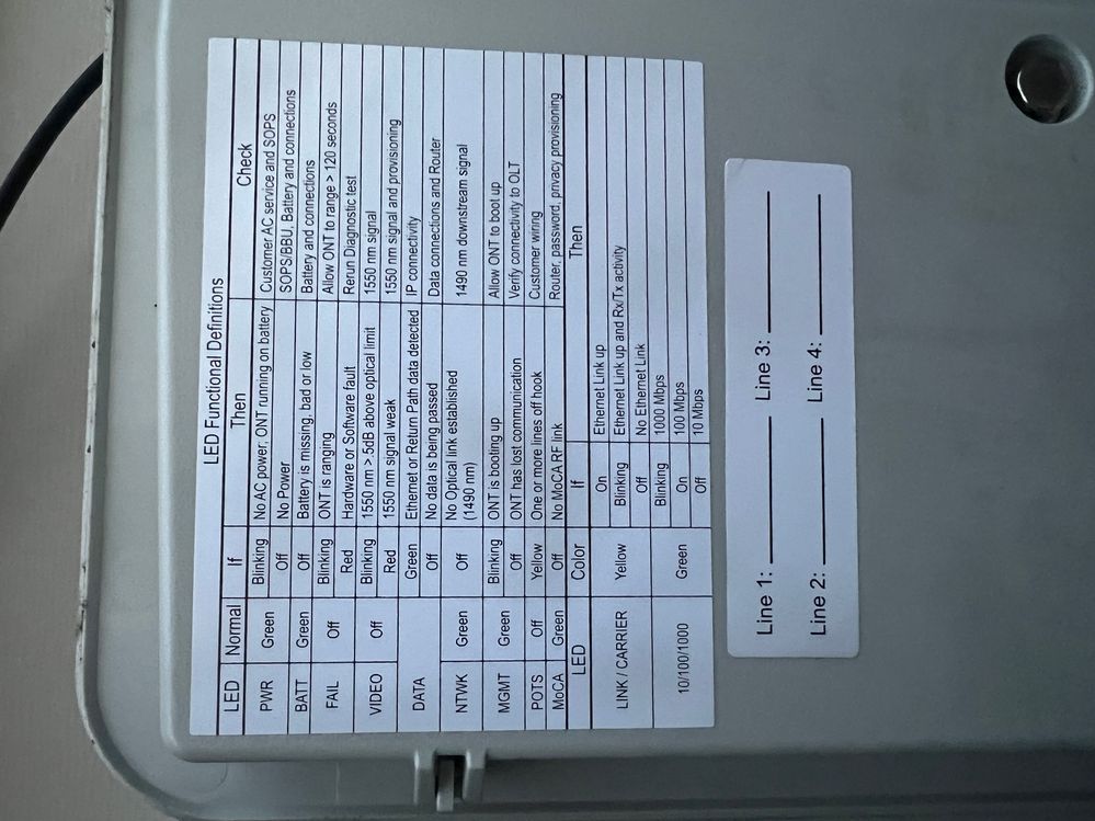

Sorry, first pic I uploaded had a serial no. and was rejected by admin. Here is the inside of ONT.

Ah...The ONT is a Motorola, which supports gigabit Internet (although Verizon no longer installs that model). I noticed the Ethernet cable plugged into the jack. That should go to the back of the router.
A few more questions (sorry if they are repeats...lots of info discussed so far)
Is it known if devices connected to the router itself disconnect or is it limited to ones connected to the extenders?
If the trouble impacts the router & extenders, could another Ethernet cable be temporarily run from the ONT to the router? The idea is to isolate the existing Ethernet cable. If the problem remains, that will point to either the router or the ONT (I don't think this is an upstream issue).
I'm not well versed on the information presented in the logs, so I'll have to defer to others on that. My suspicion is that the ONT, given that it is an older model and is located outside of the house, is the problem...again, just a suspicion. 🙂
Nowadays, Verizon looks to install ONTs inside whenever possible. The sheltered/protected environment helps to prolong the life of the electronics. The Tellabs 611 ONT that Verizon installed in our basement lasted roughly 13 years. It was swapped out with an Alcatel-Lucent (Nokia) 211 when I bumped up to gigabit Internet service.
Verizon support can access the logs in the ONT for review.
