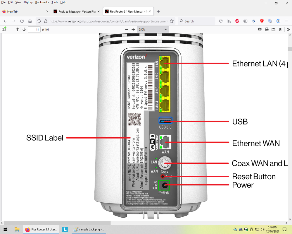

@Loudanew wrote:
- Not sure what NAT stands for. The router says Verizon all over it.
Some where on the unit, it will say the model on it.
For example from https://www.verizon.com/supportresources/content/dam/verizon/support/consumer/documents/internet/fio...
On 11 of 191 pages, it shows this image.
sample back of unit
Where it clearly says that the unit is the G3100.

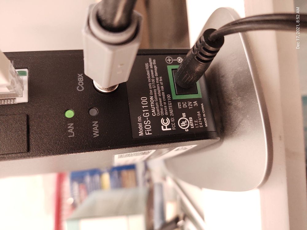

I was more persistent finding the model number. It is FiOS-G1100. Interesting when I turned it to look at it, the light went red on the front saying no connection. I figure a picture is worth a thousand words. No other fios boxes other than the set top box.

That's a G1100, which is good router.
What exactly do you mean by "pause?"
From the picture, I can tell you're provisioned for Ethernet WAN. That's the Ethernet jack just above the coax jack. There is another light on that Ethernet jack, what is it's status? Does the status change when the router "pauses?" Note a blinking green light is normal - it indicates traffic. Solid light is good, too, it indicates a good link without any current traffic.
The "globe" light on the front may turn red at power on until the router connects to the Verizon network. This shouldn't take too long; probably well under a minute. Does the light turn red again when the "pauses" occur? Does it blink? If so, how fast?
My best guess at this point is a bad Ethernet cable between the router and the ONT. Make sure everything is plugged in tightly. If that doesn't help, try a different Ethernet cable. This may mean you have to move the router closer to the ONT. If that still doesn't work, it's possible the router has failed after many years of use. In that case, know you can buy a used G1100 online for about $40. No need to spend $300 on their latest and greatest model (unless you want WiFi-6, that is...)
