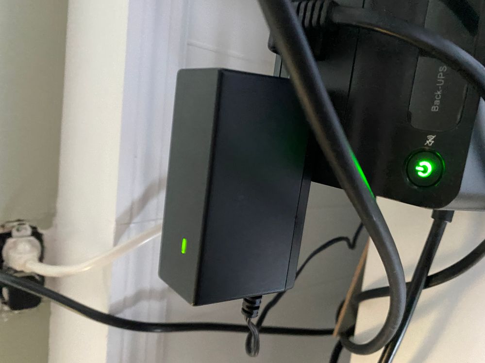

I set up the new router (G3100) the other day and I keep having the wall electrical plug gets extremely warm and the green light on the plug goes to a slow flashing red and it disconnects the wi-fi.... I unplug it let it cool and plug it in again.and it works for a while and then it happens again. It's the the same plug that I had the old verizon router plugged into for years without any issue.. The router itself is on a open counter with plenary of airflow.. When working it's doing great... just can't have it going out all the time
Anyone have any idea what is causing this???

Are you using the G1100 power adapter for G3100? That's a very bad idea. G3100 requires significant more power than G1100 due to the presence of more modules. G3100 needs 12V/3.5A, while G1100 is fine around 12V/2.0A.

nope... using the one that came with it... totally different type of plug than the old one
It's weird.. the whole plug doesn't get hot, just where the wire from the router comes into it...where it goes into the outlet is fine

this is the plug
This is the plug... I put it out this way for air to get to it and it still overheats....

Do you have a multimeter at home you could use to measure the current draw of the router? Of course, measure the DC current on the power adapter's output side for safety. I am also assuming you have basic electrical knowledge.
