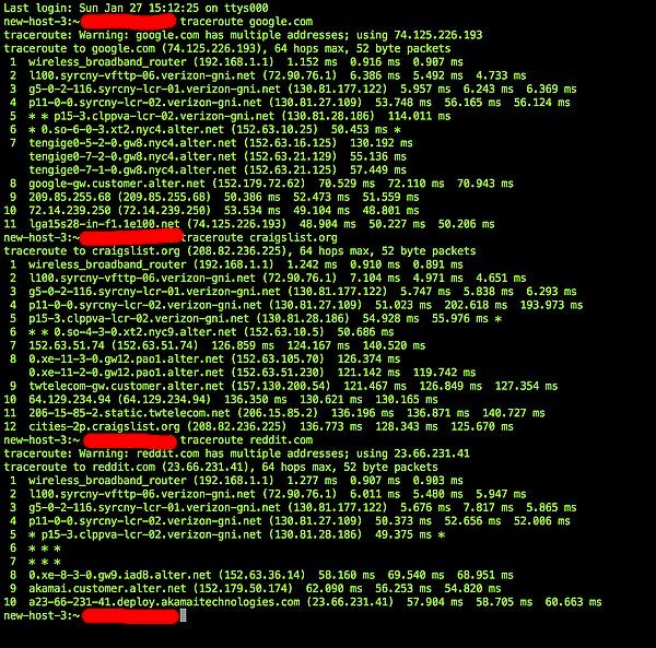

I just wanted to bump this with my own new latency issue.
In the NJ area, on FiOS and have had a recent jump.
My specific test case is a game called Mechwarrior Online. The game servers are located in eastern Canada.
Average ping for the past 6 months has been steady between 40-60ms.
Now average ping is consistenly 120-130. This is within the week around Christmas as many other reported.
This was tested with two machines inside the home one via WiFi one via CAT6.
Happy to conduct and post tracert's but It seems that further verifying the issue is not whats needed at this point.
if anyone wants me run one to a specific server as another datapoint let me know.
Thanks, and happy to be of assistance to this cause.

While you're probably right I figured i'd toss up one trace, just for the heck of it.
Look familiar? 🙂
1 <1 ms <1 ms <1 ms Wireless_Broadband_Router.home [192.168.1.1]
2 8 ms 6 ms 14 ms L100.NWRKNJ-VFTTP-94.verizon-gni.net [98.109.1291] 3 11 ms 12 ms 13 ms 130.81.185.116
4 10 ms 9 ms 9 ms ae0-0.NWRK-BB-RTR2.verizon-gni.net [130.81.209.12] 5 10 ms 9 ms 12 ms xe-6-1-1-0.NY325-BB-RTR2.verizon-gni.net [130.8123.230] 6 12 ms 12 ms 11 ms 0.so-4-0-0.XT2.NYC4.ALTER.NET [152.63.9.249]
7 15 ms 16 ms 13 ms TenGigE0-7-2-0.GW8.NYC4.ALTER.NET [152.63.21.129 8 106 ms 108 ms 109 ms tinet-gw.customer.alter.net [152.179.72.122]
9 164 ms 131 ms 127 ms xe-4-3-0.tor10.ip4.tinet.net [89.149.184.110]
10 146 ms 142 ms 136 ms internap-gw.ip4.tinet.net [77.67.71.62]
11 137 ms 136 ms 142 ms border1.te9-1-bbnet2.tor001.pnap.net [70.42.24.16] 12 * * * Request timed out. 13 * * * Request timed out. 14 * * * Request timed out. 15 * * * Request timed out.

honestly, i think when we see 'tinet-gw.customer' that infers that they themselves are a customer of mci business or verizon business and bought that connection. that means they probably bought X amount of bandwidth and are getting hammered. they likely need to upgrade that connection to something beefier. I used to work in a NOC and we saw that all the time. If a customer of ours was being saturated with bandwidth, the best we could do was call them, notify them and ask if they wanted to buy more bandwidth. If it's nearing 100% useage, there is only a few ways to go, get more bandwidth, employ better load balancing among their routers, or live with it.
So double check with them if that;s their ckt they are leasing, if it is see if they can tell if it;s being saturated. If they are leasing it, then they are verizon's customer on that connection, and they will have to get that info. for anti competitive reasons I couldn't share that kind of intimate detail with anyone but the customer.
There was another user here named smith, that shared that the GW-customer, meant that it was a leased line from Verizon.

FYI - other forums have a similiar issue, a senior member states
tinet-gw.customer
Thats a peering point, its not Verizon's issue but the games ISP isn't paying for the bandwidth there customers are trying to consume
tinet comes up allot on people complaining about bad pings, if your paying for that game service, complain, its their issue, not Verizons

Tracing route to 70.42.29.65 over a maximum of 30 hops
1 1 ms 1 ms 1 ms Wireless_Broadband_Router.home [xxxxx]
2 6 ms 5 ms 5 ms L100.PITBPA-VFTTP-03.verizon-gni.net [xxxxx]
3 6 ms 5 ms 8 ms G0-1-1-5.PITBPA-LCR-21.verizon-gni.net [130.81.191.196]
4 12 ms 12 ms 14 ms xe-19-0-8-0.RES-BB-RTR1.verizon-gni.net [130.81.209.74]
5 15 ms 14 ms 14 ms 0.so-7-1-0.XT1.DCA6.ALTER.NET [152.63.39.169]
6 48 ms 22 ms 20 ms 0.xe-0-0-0.XL3.IAD8.ALTER.NET [152.63.32.214]
7 15 ms 15 ms 15 ms GigabitEthernet6-0-0.GW8.IAD8.ALTER.NET [152.63.33.13]
8 18 ms 19 ms 20 ms tinet-gw.customer.alter.net [152.179.50.30]
9 40 ms 39 ms 39 ms xe-3-3-0.tor10.ip4.tinet.net [141.136.110.9]
10 43 ms 65 ms 45 ms internap-gw.ip4.tinet.net [77.67.71.62]
11 42 ms 42 ms 43 ms border1.te7-1-bbnet1.tor001.pnap.net [70.42.24.132]
12 40 ms 40 ms 40 ms 70.42.29.65
Trace complete.
C:\Windows\System32>
Primetime on saturday. Turned my router off for about an hour this evening, my routing is different now. Hope it stays like this. Not sure if anything changed at tinet or not.

Routing changed for me as well...
As you can see its still not ideal and somewhere on alter.net is always the root cause.
2 6 ms 6 ms 7 ms L100.NWRKNJ-VFTTP-94.verizon-gni.net [98.109.129.1]
3 9 ms 9 ms 9 ms G0-5-4-7.NWRKNJ-LCR-22.verizon-gni.net [130.81.183.183]
4 9 ms 9 ms 9 ms so-6-1-0-0.NWRK-BB-RTR2.verizon-gni.net [130.81.199.16]
5 10 ms 9 ms 9 ms 0.ge-0-3-0.XL4.EWR6.ALTER.NET [152.63.5.225]
6 94 ms 95 ms 97 ms 0.ge-6-1-0.XL4.LAX15.ALTER.NET [152.63.113.170]
7 95 ms 99 ms 94 ms POS7-0-0.GW3.LAX15.ALTER.NET [152.63.112.109]
8 93 ms 89 ms 88 ms internapGIGE-gw.customer.alter.net [157.130.236.110]
9 90 ms 90 ms 89 ms border1.te3-1-bbnet1.lax015.pnap.net [216.52.255.56]
10 80 ms 81 ms 82 ms oversee-3.lax015.pnap.net [63.251.209.150]
11 86 ms 84 ms 86 ms 208.73.208.10
12 83 ms 81 ms 82 ms host204-13-160-107.oversee.net [204.13.160.107]
As far as my tests, I have actually been in contact with members of the games support team. They confirmed that tracing to their website www.mwomercs.com will yield the same results as a game session (same data center).
To anyone who wants to help push this along, I do have an open case to verizon, not bound to my account name.
You can actually use the online chat support option just to bump the case, and help it get more attention if you are so inclined.

You're jumping from Newark, New Jersey to Los Angeles, CA in that trace. While Verizon's backbone may not route the best in regards to latency (I can get 55-60ms at work from New York to Los Angeles) but that's about typical for a coast to coast jump in many providers around here. Did you ask the owner where their server is located?
The trace also looks consistent beyond the alter.net hops but it certainly doesn't mean it is okay to blow off the alter.net hops as a problem. They do have ICMP traffic on low priority though which is common across many backbone routers.
Also keep in mind that ANYTHING labeled company-gw.customer.alter.net such as tinet-gw.customer.alter.net is a peering point. If you see high latency at these, the person on the other end either did not purchase enough capacity from Verizon or the router being used is underpowered for the job it's taking on, it's having a problem, or it's set up to place ping requests on low priority. As to who is or what is at fault is unknown since you'd have to research the peering agreements between the two companies. The higher speeds are certainly not helping anything though, since companies tend to drag their feet in upgrades.
This is from a 5Mbps DSL connection with Verizon.
Tracing route to host204-13-160-107.oversee.net [204.13.160.107]
over a maximum of 30 hops:
1 <1 ms <1 ms <1 ms 192.168.3.1
2 7 ms 7 ms 7 ms 10.41.15.1
3 6 ms 6 ms 7 ms P1-0.BFLONY-LCR-01.verizon-gni.net [130.81.195.144]
4 17 ms 16 ms 17 ms so-6-3-0-0.NWRK-BB-RTR1.verizon-gni.net [130.81.28.138]
5 17 ms 17 ms 31 ms 0.xe-6-0-4.XL3.EWR6.ALTER.NET [152.63.4.77]
6 98 ms 98 ms 98 ms 0.xe-6-1-0.XL3.LAX15.ALTER.NET [152.63.112.146]
7 99 ms 99 ms 99 ms POS6-0-0.GW3.LAX15.ALTER.NET [152.63.112.105]
8 119 ms 114 ms 112 ms internapGIGE-gw.customer.alter.net [157.130.236.110]
9 116 ms 116 ms 117 ms border1.te4-1-bbnet2.lax015.pnap.net [216.52.255.120]
10 87 ms 88 ms 88 ms oversee-3.lax015.pnap.net [63.251.209.150]
11 93 ms 93 ms 93 ms 208.73.208.10
12 92 ms 92 ms 92 ms host204-13-160-107.oversee.net [204.13.160.107]
Ping to the same server (shows congestion is not abound for the route)
Pinging 204.13.160.107 with 32 bytes of data:
Reply from 204.13.160.107: bytes=32 time=92ms TTL=244

Having similar issues in Upstate NY (Syracuse Area)
