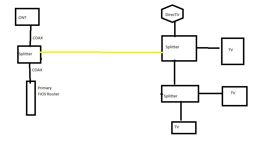

Sorry for the crudity of these diagrams
The first diagram is my current set up
When I make the connection between FIOS and DirecTV without the second FIOS router in the mix the Primary FIOS WAN connection goes down.
This is the issue I'm trying to figure out why the FIOS WAN connection goes down when making this connection.

Are you sure that Fios signals and DirecTV signals operate on fully separate frequency channels?

FiOS use moca to carry internet signals over coax. A quick Google says DirecTV can not run on a network using moca as it will interfere.

DirecTV and FiOS Coax cannot coexist connected to each other. The ONT is capable of backfeeding out to the dish and will interfere with the operation of the satellite service. DirectTV also utilizes MoCa, and this can interfere with FIOS.
To do what you're trying to accomplish, you'll need to keep any connection from DirecTV to FiOS separate. If you're able to, pull enough coax from the FiOS Splitter to connect up to the coax line in the unused bedroom. Disconnect from the DirecTV Splitter, and use a Coax coupler to join together the two Coax cables. That should solve the problem you're having.
This FAQ, once you have a Coax connection in the room which connects only to FiOS, will help you out with the rest: https://www.dslreports.com/faq/15984
