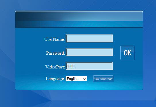

I can. On a browser each camera ip opens a page where I can login using the login/password settings I created in the app.
Attached is what appears in the browser when I enter the IP of one of the cameras.
If I enter the correct login info, the camera image appears just like in the app.
But, the problem is that particular camera's ip does not stay constant for very long because it does not stay static despite being set that way.
