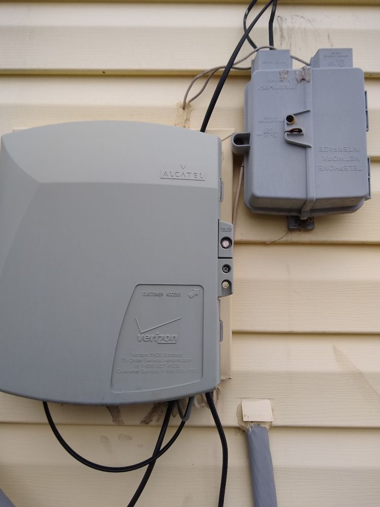

Thanks. Looks like it's not coming from the power supply because I unplugged it and it still beeped. It sounded like it was coming from the ceiling of the furnace room. The power unit and the router is in the furnace room but I could not find the BBU. l looked outside and there's a box outside I'm assuming the BBU is in there. I haven't opened it because it was very cold yesterday and now we have snow so it will have to wait a few days. Is this the box where the BBU is located?

BBU's are never mounted outside as the batteries are not rated for outdoor usage.
The picture shows an ONT enclosure and a telephone network interface device (NID,) which is where the phone lines are connected. It's upside down, which is rather odd. The opening are designed to be on the bottom so water doesn't get inside the NID. An upside down install like that will encourage water to enter and will ultimately lead to excess corrosion and noisy phone lines. It's possible it was removed from service when the fios ONT was installed; I can't tell from the picture.
As for the BBU, keep looking around inside. If you found the power supply, follow the wires from it and they will lead you to the BBU.
