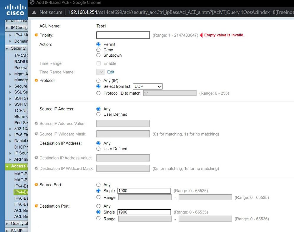

Yes. You just need to place the extender and the router on two separate network segments. E3200 discovers G3100 through SSDP, which uses IGMP and IP multicast. Multicast has TTL of 1, so a layer 3 device between the router and the extender can effectively stop their discovery of each other.
Another method is just to have a quasi-firewall device between the two to block UDP port 1900 for SSDP. Creating two network segments and quasi-firewall can both be accomplished through a managed switch.
A managed switch with port-based firewall is not typically found in the consumer price range, however.
For example, I would configure it as such in my switch.
Cisco ACL Config
Cisco ACL Config
