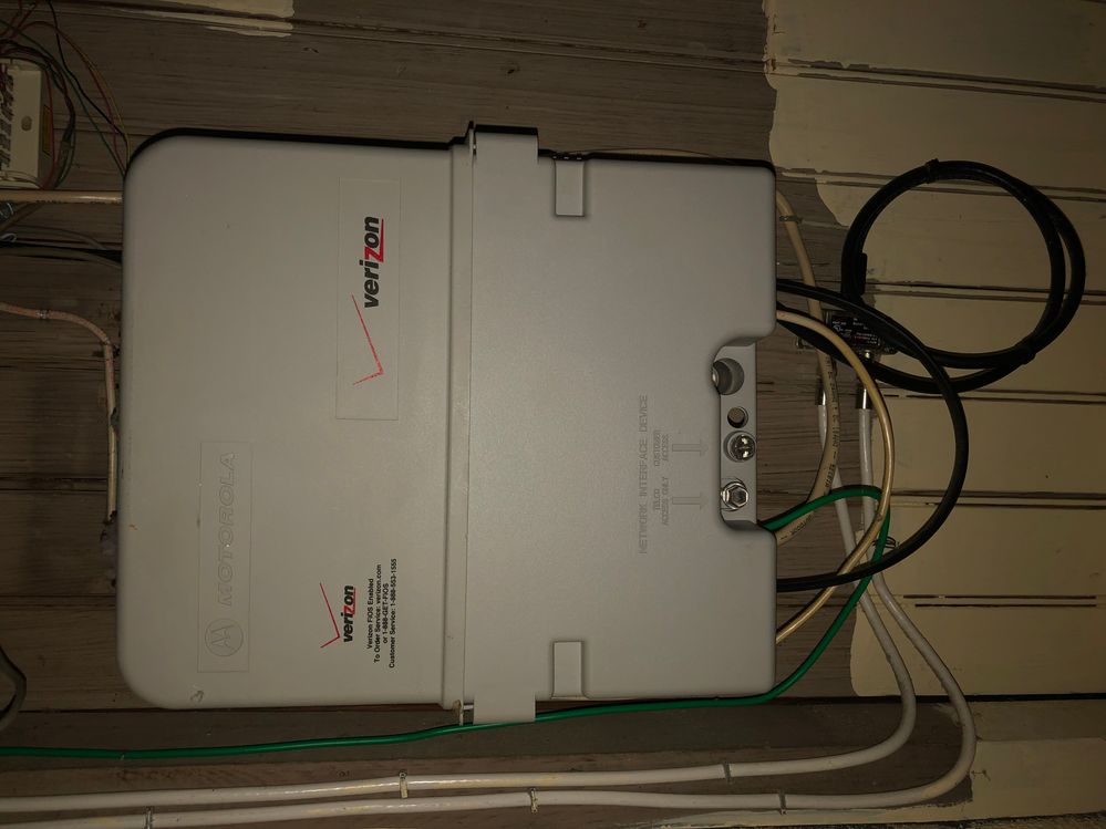

Thanks so much for your help. We need to upgrade the DVR because it's on its way out (picture/guide freezes and I have to reboot) and because the guide is just, and always has been, excruciatingly slow. The DVR model is Arris VMS1100, the STBs' are Arris Ipc1100P2, the router is actiontec M1424WR, and I've attached a pic of ONT. Again, I'm using Google Nest as my actual router. I'd be happy upgrading to 100mbs I just would prefer that any new gear work with coax so I don't have to rewire my house. Thanks again!

Verizon FiOS hardware works well with coaxial cable. Note that Internet speed will be kneecapped when using it to connect the router to the ONT.
The router and STBs are long in the tooth and should be upgraded. Once the image of the ONT is approved by a Moderator, we'll be able to see what is installed.
