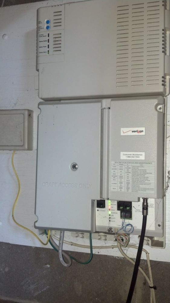

I do not have Verizon Fios for my cable etc. but the previous tenant did. In the mechanical room on the patio is a Verizon box that looks like the pictures below. It has lots of lights on it and they are mostly green but one labeled FAIL is blinking red and the box beeps about every five minutes (I think, I haven't timed it). This has been going on for months now. I tried calling Verizon but (of course) didn't have any success there. Maybe it's because I started out with "I don't have an account with you, but...." Once they sort of understood what I was trying to explain they wanted to transfer me to another department (even though I called the number printed on the box) and of course that's when I got cut off. I don't want to try again....I just want to make the beeping stop, hopefully without possibly cutting off the service to other units in the building. Anyone got any suggestions? (In the picture the FAIL red light is not on but that is only because it blinks and was off when I snapped the picture)

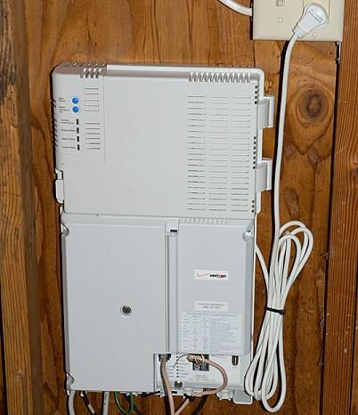

Okay, now I understand the source of the confusion. We couldn't understand why you didn't just unplug it. Most interior installations look similar to this:
In which case you can just unplug the AC cord, disconnect the battery, and the alarms go silent. But either your ONT is wired differently, or at least the installer hid the AC cord where you cannot see how it attaches (possibly by poking it through the wall). So if you cannot find an electrical plug that looks like this and is marked "Telco Use Only Do Not Remove", I will list two alternative ways to "unplug" the box.

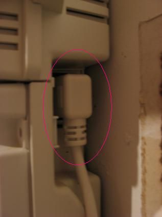

The first is to look on the right side of your box where the AC cord disappears in the pic above (about half-way up). You should see an attachment that looks like this:
Pull it out.

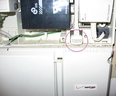

If you cannot find this attachment, open up the box cover where you found the battery. It should look like this:
Pull out the two-prong plug shown in the red circle.

Hi bethelonia,
While I'm not an expert in all things Verizon, I believe that each apartment unit should have its own ONT (that's the name of the box in the picture). When I look at your pictures, I notice that this does not appear to be a properly functioning box. More specifically, it appears that this box is not communicating with the network. This would lead me to believe that it is indeed a non-functioning box that has been left there by the previous tenant. It would probably be fine if you pop open the hinged cover to the upper part of the box (see pull tab off to the left side beneath the buttons and lights), unplug the battery wires from the unit, close the cover and unplug the box. This should shut the box completely off and stop it from beeping.

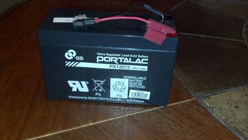

Thanks so much for these helpful replies! You inspired me to investigate further and upon doing so I discovered that THIS is what is making the beeping noise:
Obviously it is a battery! I would assume it needs to be replaced, but I certainly won't do so since I don't even use the Verizon service. So....what can I do to it to make it stop? I could just hide it in a closet somewhere, or I could dispose of it, but I am reluctant to do so since it's not really mine. More suggestions please!

The battery itself should not be making the noise. It is just a battery. The ONT is making the noise, possibly because the battery is low or dead. There are only two ways to make the noise stop. Follow the instructions above (unplug the battery from the ONT and unplug the ONT from the outlet), OR replace the battery.
The picture of the battery just became visible. You do not have to remove the battery from the unit, as long as it is unplugged, it can remain within the ONT.

As all earlier writers have stated, the noise you hear is due to a faulty battery. However contrary to your statement, the battery itself is not making the noise. Batteries are used to power devices that themselves may be able to make noise. A typical example is the transistor radio (those not steeped in 20th century lore can substitute "iPod" for "transistor radio").

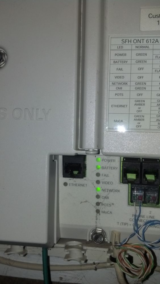

In the present case, the noise-making device is an Optical Network Terminal (ONT) Model SFH ONT 612A. To silence this device, one must either repair the defect that is causing the noise (i.e., replace the battery, a route you have rejected), or somehow render the ONT incapable of making the noise by removing its power source (unplug the device as all writers have suggested or as suggested by another writer, disconnect the battery; this route you have also rejected).

P.S. to Armond......I DID disconnect the battery, how else could I take a picture of it sitting on a table? And that's where it continues to sit, yet the beeping continues!

Ok, here's what I did now: I put the battery back in (based on reading the four pages linked to me by Armond, thanks!) and indications are that the battery is fine! The "replace battery" light is not on! What IS on is the FAIL light on the big lower box, and then it says if the FAIL red light is on that indicates "daignostic test failure" and if the red light is flashing, which it is, that indicates "passed test, not communicating".
So clearly it has passed the test but is not communicating! A situation which apparently calls for a periodic beep!
Pull it out.
