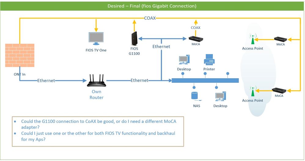

Thanks Charlyc.
I posted another question separately, but would you think the following would work? Assuming i am on with Moca 2.0?
I am hoping to eliminate one of the three moca adapters in the figure, and use the G1100 to serve as an adapter as well as for Fios TV.
Thank you for taking the time to review and respond.

I don't see why not.
