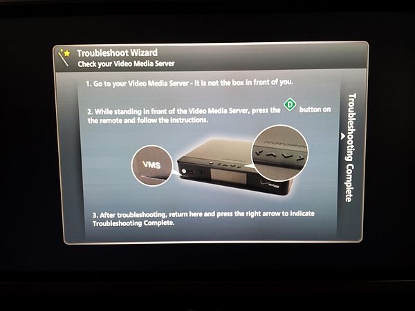

About a week ago, two of the IPCs stopped working where they say "network connection can't reach the VMS."
Try all troubleshooting and never resolves.
Funny thing is that the VMS can see those two boxes (but no longer sees them with the friendly name they used to have such as "Master Bedroom") but yet the boxes say they can't connect to the VMS. Furthermore, one of the boxes eventually says that I can watch limited television (but can't access DVR) but if I go into the settings I can see that the box reaches the Internet, can access widgets, yet it can't connect to the VMS (again the VMS actually sees the box and the VMS can REBOOT the box if I ask the VMS to troubleshoot the box which is an option in the Settings, Customer Support options).

Update:
Came home today and my third IPC box now has the same issue and stuck on the network connection screen. It was working this entire week when my other two were not. I'm guessing my VMS will go down soon?
