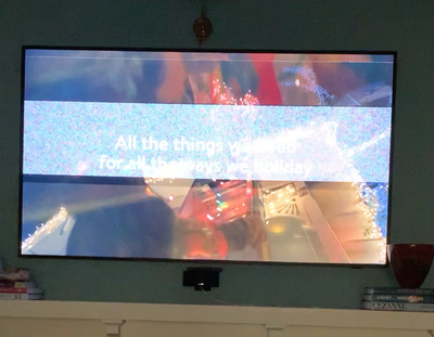

Everything was fine until we bought a new Samsung tv. Hooked everything up (Bose, Apple TV, Fios DVR just like it had been before but now, when trying to watch tv through the DVR we have intermittent pixelation and distortion that is so bad it is unwatchable. We can watch the Samsung tv with out issue if we bypass the Bose system. We can watch the Apple TV through the Bose system without issue but when we hook up the DVR through the Bose to the Samsung we have issues with the distorted picture. The other TV's in the house have no problem with the pixelation and distortion . We have rewired, reconnected, turned off and on, reset DVR, replaced DVR, replaced cables, etc, all to no avail. Why all of a sudden would the Bose sound system cause problem with the cable signal?

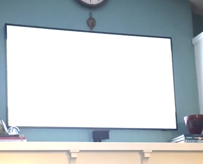

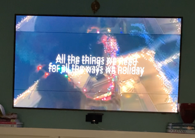

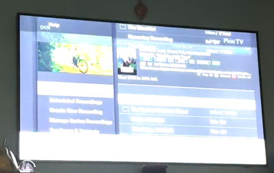

Thanks for the quick reply. It is a Samsung Frame TV. The Bose system is from 2013. The Bose is the only variant that is causing the trouble. All other hook ups and TV's are fine. It seems the Verizon and the Bose are not getting along. All the cables and cords are high end, and the STB has been replaced ( that was Verizon's solution). It didn't help.
The picture and sound become super glitchy with black outs, whiteouts, overlays, split screens, pixelation, and it is not all the time. It will resolve and be fine for days and then off it goes again. Often, just the switch to the Apple TV to watch something (which works fine through the Bose ) and then a return to cable will set it off. I've attached some images

Thanks for the info. We'll give that a try. We thought perhaps the Bose system was too old for all the new tech.
