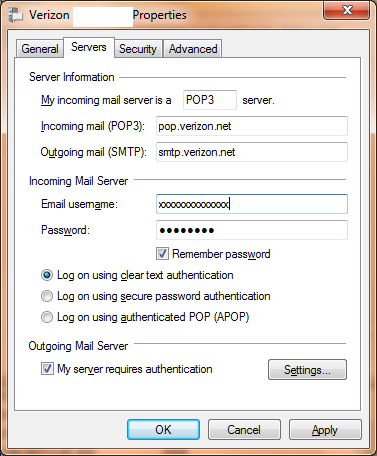

Sounds like good settings. You might want to try setting the smtp and pop userid and passwords seperately rather than using the option to use the same. Some have found that helped. Screens from my MS Live Mail attached.
