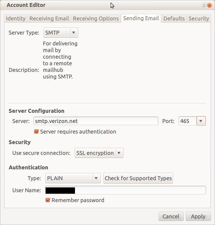

Settings for outgoing server as you specified:

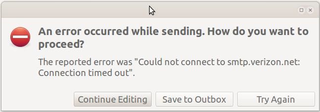

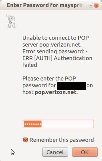

Error messages while sending:

I don't know if it means anything since you said plain text. But the option check for supported types is what caused others problems with some of the other mailers. Verizon or what ever software they are using, was (and maybe still is) incorrectly advertising the support of CRAM-MD5. Since it doesn't actually support it, then if Evolution were to try and use it, login will fail.
ps: One of the error message you showed is for the POP, i.e., receiving side. Hopefully it has similar setting to what you showed on the Sending side.
