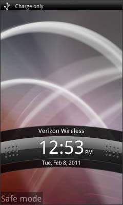

Have you installed any apps, if you have multiple devices doing the same thing it may be a app and it does not have to be a camera app, I suggest you check all apps you installed to make sure they are not linked to the camera in any way or I would hard reset the device and do not install anything and then try the camera, if it functions correctly it is most likely a application causing your issue..
Try booting into Safe Mode and see if issue goes away...
Enable Safe Mode

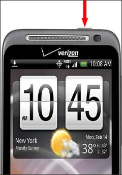

- With the device powered down, press and hold the power button.
- When the second HTC Logo screen appears, press and hold the volume down key.
- Release the volume down key when Safe mode is displayed at the lower-left.
This may take up to 30 seconds.
- While in Safe Mode, remove the most recently installed applications.
- Power cycle the device then attempt to use the device.
- If the device works properly, install applications one at a time to identify the application causing the problem.
Disable Safe Mode..

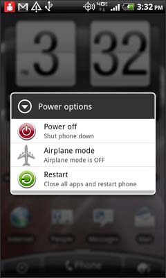

- Press and hold the Power button.
- Select Restart.
