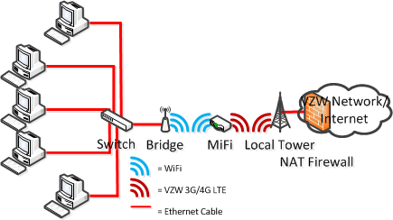

"Monitored" is my personal word for the scenario. Didn't mean to stir up anything by it, but I think you get the gist. We don't know if VZW can "see" our local traffic or not, that's a conspiracy conversation outside the scope of the current problem. However the bill should not reflect your truly local activity. I don't doubt anyone's technical skills here, just saying no one has been able to prove it so far. If you can find a way and capture the problem VZW should be able to refund you something for your efforts.
I'd be happy to work with you and answer any questions you have on the subject. Likewise I'd be interested to reproduce any steps you can document for us to help you build your case. I can tell you right now that we as users cannot see exactly what Verizon sees when it comes to preparing the bill. This is primarily the largest obstacle when it comes to determining a leak. The raw data from our usage logs are hidden from us to protect our own privacy (or something like that). All VZW will provide users with is a log of the various sessions. Anything deeper than that needs to be rigged up with the use of monitoring devices and applications before the traffic hits the Jetpack.
For example you could have an environment like this at home:
In this example the best spot to setup a monitor would be at the bridge. Monitoring from here would capture everything headed to the internet. The Jetpack could also use simple MAC filtering to ensure that only the bridge is connected to it and keep your logs clean from interference. How granular you get from here will depend on your level of investment and interest into the subject.
Let me know if you have any questions.
