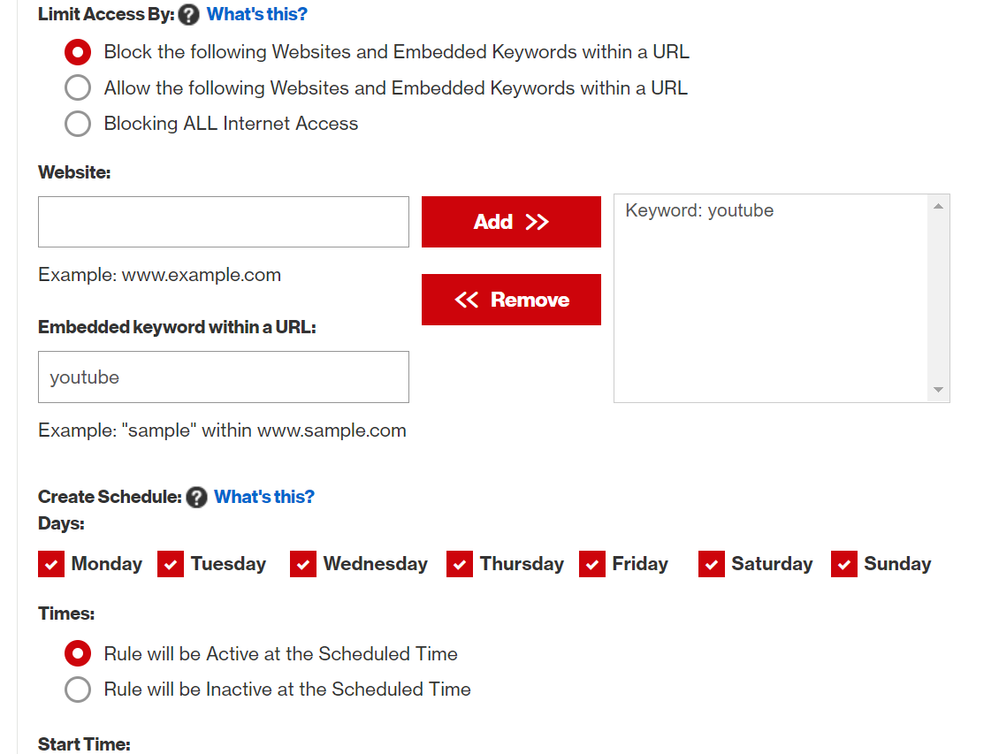

Have you done something like this? Can you screenshot the entire configuration page? It seems something is misconfigured.

Hi - yes, this is exactly what I have configured, thank you!
In addition, in the window you show, further up on the page I have selected the devices (in this case I just selected all devices). Additionally, below where this screenshot is, was the selection for the time, I chose 7:00pm to 12:00pm.
I did this because I wasn't sure how to specify 'All the time' - it is a bit confusing because the start (and end time) would both be 12:00 AM, for something that I want always on.
Unfortunately - I the screenshot here is greyed out. In my troubleshooting, I installed the My Fios App on my Android phone, then selected to turn on 'Home Network Protection', I've since turned Home Network Protection off, however, I can no longer 'see' the full detail that your screen shot shows.
Here is what I can see - I'm in the support queue now to hopefully revert the Home Network Protection setting from the My Fios App, fingers crossed.
Can you confirm that with those settings you have screenshot, that the device is in fact restricted from youtube.com? I had a friend / neighbor try the same configuration as me and they were able to confirm that this configuration did NOT block that website. Thank you!
