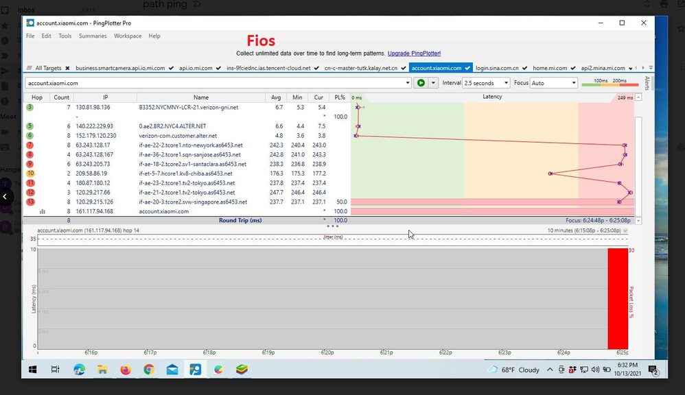

My parents had switched from Spectrum to Fios. Now their IP cameras, cannot be accessed. I have the same IP cameras at my home. Only when I try to access my cameras on Fios, they do not work. I can access my cameras on any other network, including mobile.

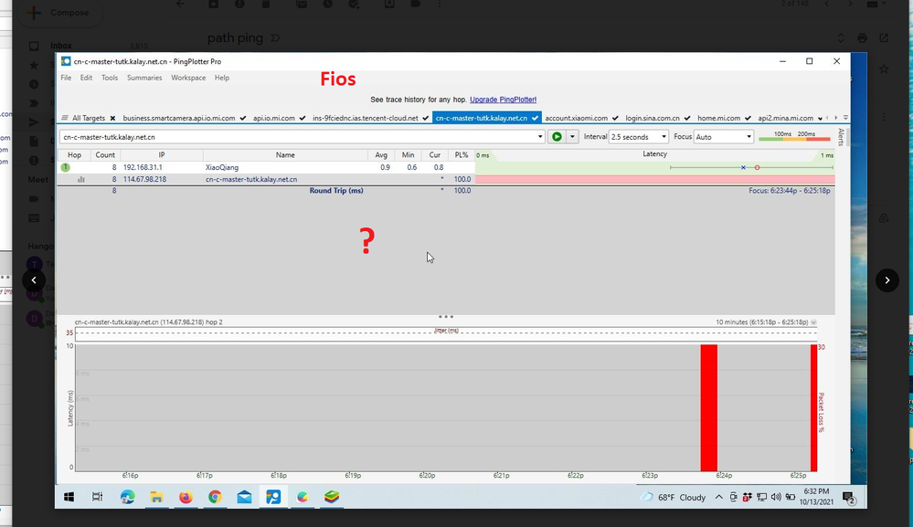

The cameras can only be accessed using the mobile app "mi Home". I installed "BlueStack" to emulate the app on my pc and used "GlassWire" to find all China hosts on my network. Then I used "PingPlotter" to trace the route for the IPs on my parent's network. I found one route that seems broken its to "ThroughTek". "114.67.98.218", "cn-c-master-tutk.kalay.net.cn"
I do not fully understand this, hoping someone with a greater understanding could help me out. I have spoken with various Verizon techs, some helpful, but with limited success. I saw in a different forum, some things hosted in China have issues?
I attached images. Thanks

Would you also be able to take a look at the images in my first post, they finally uploaded. In one of the images, it doesn't make it past the router. What does that mean?

Tunnel Bear is a third-party VPN vendor. Tunnel Bear extends their network to you, which has nothing to do with extending your local network remotely. To allow a remote device to be on your local network, you need to host your own VPN server at home.
I had seen your images. Your images need to be approved by the moderators first before other users can see them. The result you are seeing has to do with your traceroute utility. VZ network blocks ICMP traceroute, so you need to use UDP traceroute instead. UDP traceroute is a built-in feature of Linux OS.

The images are UDP traceroutes, two of the images are on Fios. The first image is showing the hops from the router to the final destination for another IP that the camera app also uses. The second one is showing the IP in question that stops after the router. The third image shows the same IP in question but on the spectrum network. Could you test the IP "114.67.98.218", "cn-c-master-tutk.kalay.net.cn"

The pinging on my end shows the IP is accessible above VZ's layer 3 network as well as other major NYM interconnect/peering. When the ping passes through China Telecom, the traceroute does not respond anymore, which is highly suspicious.

From what I can tell, the whole subnet is not routing. https://bgp.he.net/net/114.67.64.0/18 . Perhaps Verizon's network is not liking the IRR issue that exists with China Unicom's announcement for that subnet. You can see evidence that is a problem with Verizon's Enterprise backbone too, AS701, by using the looking glass: https://enterprise.verizon.com/why-verizon/looking-glass/ . If you submit 114.67.64.0/18 in a BGP Query, nothing returns back meaning Verizon's network doesn't know how to route to it.
I would personally DM Verizon on social media and stress that this is a routing issue someone on their network team needs to look at. Mention the resource on the other end is being used for security cameras.
