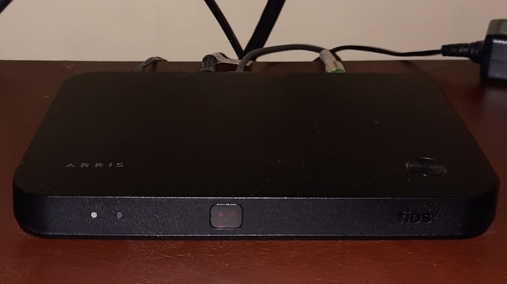

Verizon ships Arris STBs for high definition TVs. For the, relatively, short amount of time that we've had them, they have been fairly reliable and produce a good picture.
I must qualify this observation with the admission that none of our TVs are 4K compatible.
The Arris system includes one unit that doubles as a DVR and enough non-DVR boxes to cover any remaining TVs.
Here is a picture of the non-DVR unit (IPC4100).
