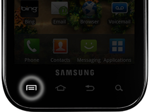

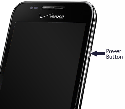

Uses complained about this when Droid X update was released and it was learned that the update was blocked by apps that was installed, some could boot into safe mode and get update to work... The only other working method was a hard reset.
Try Booting into Safe Mode and then check for update by....
- Press and hold the Power button.
- Select Power off.
- Press the Power button.
- When the Verizon logo appears, press and hold Menu.
- Safe Mode will display in the lower-left.
- Select Power off.
