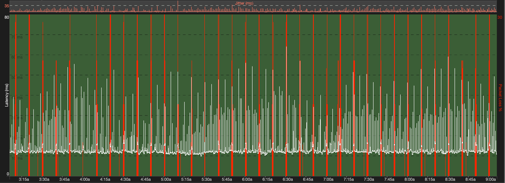

Packet loss every 10 minutes in Westchester for dozens of people.
GTT1
Enthusiast - Level 2
Hi,
It appears that at least 50 of our users working from home (all on FIOS) are having packet loss every 10 minutes (on the :00 :10 :20 :30 :40 :50 marks pretty much within the first minute) to our network. According to traceroutes and pingplotter graphs, this happens around the alter.net network ranges (eg 152.179.78.154, 140.222.1.61) It has been happening since last week. We have confirmed that other ISPs that take different routes do not have this issue.
We have asked them all to call you and let you know, but of course you make them do the "restart your router" dance and claim you don't see issues with your network.
If anyone at verizon wants to reproduce this packet loss issue, just run a pingplotter (or any packet tracing tool) to just about any lighttower IP: eg 144.121.109.78 (as of this post, seems like all of your FIOS customer packets to that network will go through the problematic hops).
Here is an example traceroute of a packet that has this issue every 10 minutes:
3 B3363.NYCMNY-LCR-22.verizon-gni.net (130.81.29.146) 7.435 ms 1.620 ms 5.590 ms
4 * * *
5 0.ae4.BR2.NYC4.ALTER.NET (140.222.1.61) 3.533 ms 3.797 ms 0.ae1.BR2.NYC4.ALTER.NET (140.222.229.91) 4.393 ms
6 verizon.com.customer.alter.net (152.179.78.154) 4.562 ms 4.137 ms 3.426 ms
7 4.69.209.82 (4.69.209.82) 4.237 ms 4.160 ms 4.69.209.78 (4.69.209.78) 2.240 ms
8 FIBERTECH-N.edge2.NewYork6.Level3.net (4.30.181.126) 3.555 ms 3.749 ms 2.733 ms
9 * * *
10 144.121.109.78.lightower.net (144.121.109.78) 2.317 ms 3.817 ms 3.510 ms
Simple mtr during one of these events:
HOST: <snip> Loss% Snt Last Avg Best Wrst StDev
3.|-- B3363.NYCMNY-LCR-22.verizon-gni.net (130.81.29.146) 0.0% 10 4.3 3.0 0.7 5.1 1.2
4.|-- ??? 100.0 10 0.0 0.0 0.0 0.0 0.0
5.|-- 0.ae4.BR2.NYC4.ALTER.NET (140.222.1.61) 10.0% 10 6.3 7.6 6.1 9.6 1.1
6.|-- verizon.com.customer.alter.net (152.179.78.154) 40.0% 10 6.8 7.0 6.3 8.5 0.6
7.|-- 4.69.209.78 20.0% 10 7.5 7.1 5.4 10.3 1.6
8.|-- FIBERTECH-N.edge2.NewYork6.Level3.net (4.30.181.126) 40.0% 10 6.6 7.5 6.3 10.2 1.3
9.|-- ae3-nycmnyzrjp1.lightower.net (144.121.35.41) 40.0% 10 6.9 6.9 6.2 8.1 0.6
10.|-- 144.121.109.78.lightower.net (144.121.109.78) 40.0% 10 6.9 6.9 6.2 8.1 0.6
You can see the packet loss propagates after alter.net. During any of the other 9 minutes, the mtr reports no packet loss to the destination:
3.|-- B3363.NYCMNY-LCR-22.verizon-gni.net (130.81.29.146) 0.0% 10 1.2 3.2 0.7 5.1 1.7
5.|-- 0.ae4.BR2.NYC4.ALTER.NET (140.222.1.61) 0.0% 10 1.5 1.7 1.4 2.4 0.0
6.|-- verizon.com.customer.alter.net (152.179.78.154) 60.0% 10 2.4 2.4 2.3 2.6 0.0
7.|-- 4.69.209.78 0.0% 10 7.2 2.6 1.6 7.2 1.7
8.|-- FIBERTECH-N.edge2.NewYork6.Level3.net (4.30.181.126) 0.0% 10 2.9 3.6 2.5 9.4 2.0
9.|-- ae3-nycmnyzrjp1.lightower.net (144.121.35.41) 0.0% 10 3.6 5.9 2.7 16.0 5.3
10.|-- 144.121.109.78.lightower.net (144.121.109.78) 0.0% 10 3.1 3.2 2.0 10.8 2.7
I'll be happy to provide more information, but seriously this is about as easy to reproduce as it gets. Please any network engineer at verizon take a look at this our users are already starting to switch providers because they can't work from home with this issue.
Thank You
imagePacket Loss every 10 minutes.
