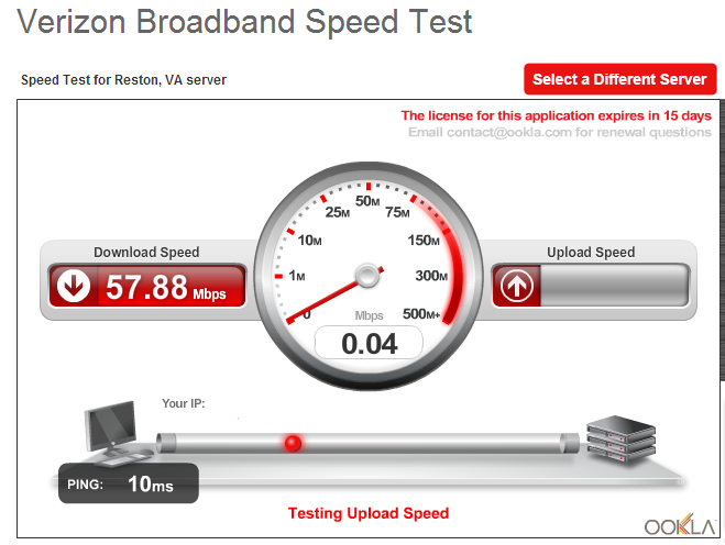

Here's even more ammo.  It actually bumpped up to a whopping .06 there for a moment. But because the test timed out, we never got a full result.
