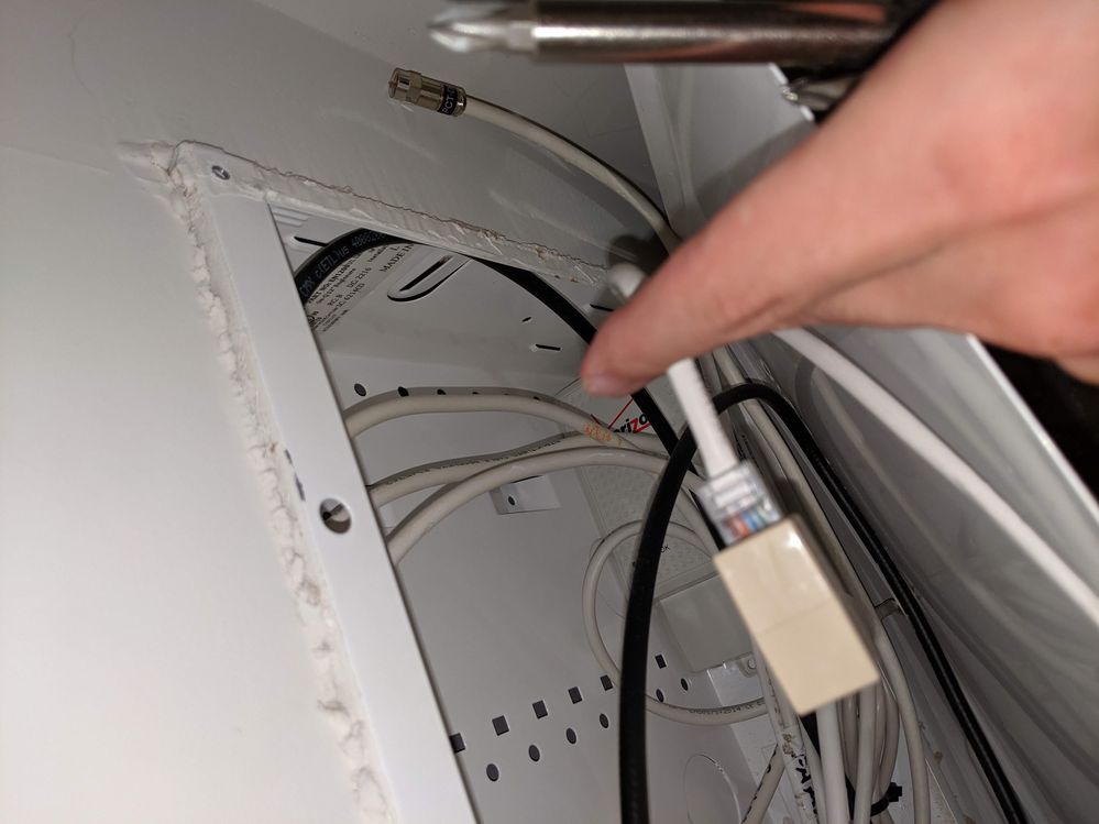

Thanks for noticing that. I took out the panel and checked inside. There were a lot of cables. And I also checked my 2nd floor and 3rd floor. Here are what I found:
image2nd floor ethernet next to STBimage3rd floor cable(yellow) next to extenderimageEnd of the ethernet cable on 3rd floor.
So this is where I become utterly flummoxed: I plug the ethernet cable on the 2nd floor into my laptop and got nothing. Then I thought "Oh it makes sense since it's not connected to the router. So I went to the 1st floor and took down the panel and saw these:
imageEthernet cable behind while panelimageConnected to what looks like an ethernet extenderimage
You can see that there is an ethernet cable with a complete port plugged in what looks like an ethernet extender. So I unplugged it and plug it in the router as I thought it must be the same ethernet cable that comes out of the wall on my 2nd floor. But it didn't work.
As for 3rd floor, the ethernet cable doesn't even have a plug-in ready port at the end. What is that about? I can't even test if it works.
What shall I do now to make the ethernet cables on 2nd and 3rd floor work? Is it necessary now to get a Verizon technician? Thanks.

To answer the first question the FiOS extender can be wired with ethernet or coax from the router.
As far as mesh routers, Orbi has multiple ethernet ports to hardwire devices. Google has only one ethernet port so it will need to wire to an unmanaged 5 port gigabit ethernet switch to add more ports.
In your white panel all the wires are probably homeruns. Which means it runs from the panel to the jack on each floor. In your setup you will have to put the main router in your basement with the panel. Plug all your ethernet wires into you LAN ports of your router. That will make all the jacks live on each floor. You will still need to buy female RJ45 ethernet jacks for the unterminated wires up in the rooms. You will also need a 110 punchdown tool to terminate the jacks on each floor.
It might be easier to call Verizon to come out but just remember it will be billable work.
