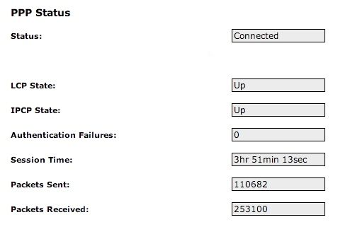

I just got Verizon DSL March 15th. I'm supposed to be on the 1.1-3 / 768 (enhanced DSL) plan. It's only running at 1.8 down and 500 up. What do I need to do to find out why it's not running faster. I know that's with the "range", but I may drop back to the .5-1.1 / 364 plan if it won't go any faster. Here are screen shots of the modem stats.

Why isn't the modem showing the sync speed? See if you can get that from the main page or from those same Statistics readings using another Web Browser if it won't display.
The line has plenty of capacity for more speed, 15Mbps if cleaned up enough, 7Mbps for sure being obtainable. I'm going out on a limb to state you're probably suffering from Juniperitus. Once you can get your Sync speeds, go to http://lg.dreamhost.com/ and post up the Reverse Traceroute presented by that website (Remove your IP address from the final hop if it doesn't end in all *'s).

OK, I don't see Juniper in that traceroute from how it normally appears. Looks to be as if you're on Redback. I need your modem's current speed as reported on the DSL Status page or on the main page of the modem to determine where you're at for speed.

 Speed(Down/Up):
2112 / 640 Kbps

Seems for whatever reason your line was set to an "Optimized" provisioning rate. Have Verizon bump your line to 7.1Mbps/768kbps and let's see how it goes.
