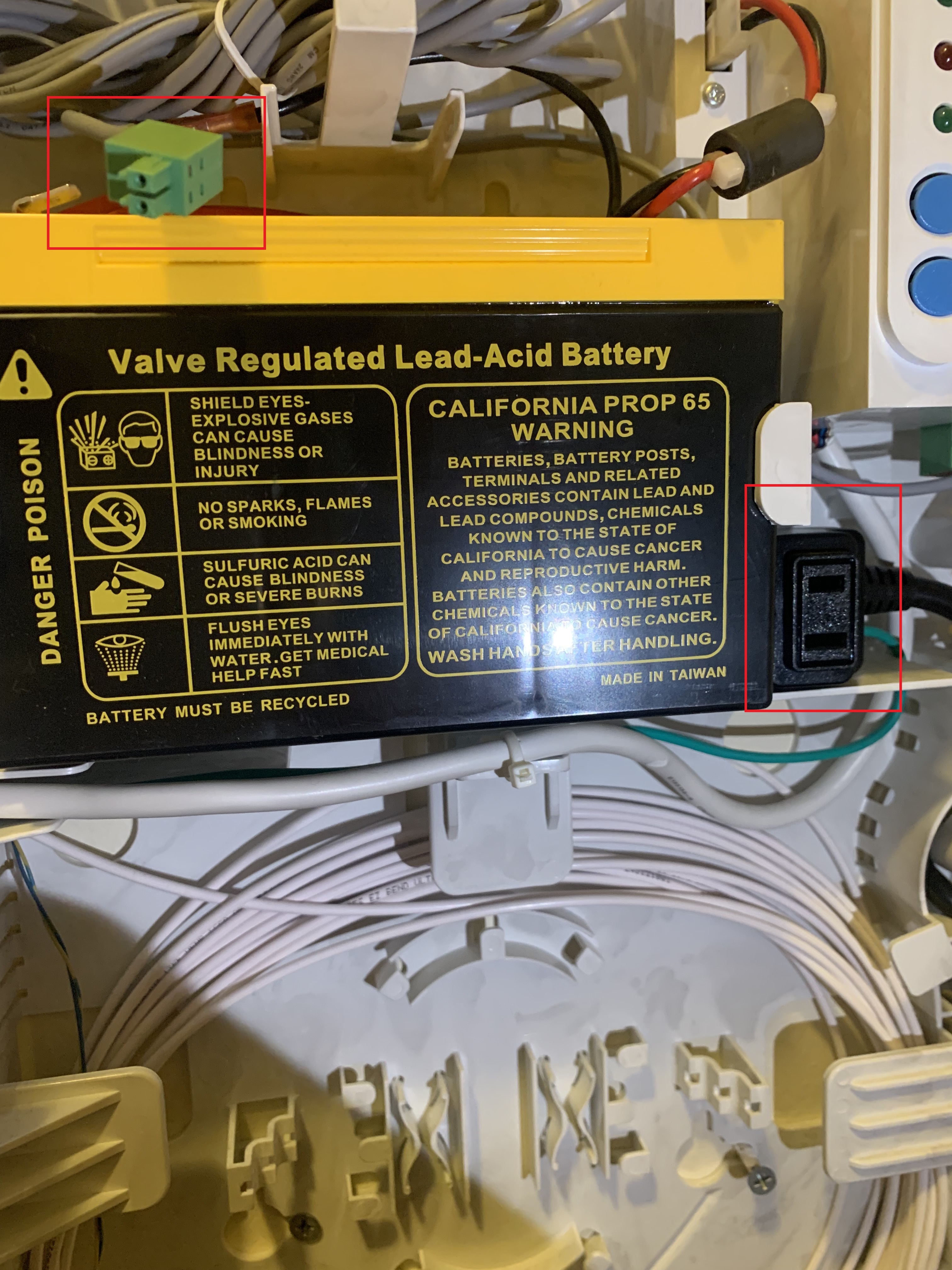

Hello, I am currently trying to self install Fios. I had Fios in this exact apartment several years ago. I moved away for work and moved back into the same exact apartment. I signed up for Fios and am trying to self install (since I had it before). When I plug in the ONT nothing happens, no lights, no beeps, nothing. I open up the ONT.
The black cord in the bottom right is the power supply. I have verified the power stip I am plugging it into works because my printer is plugged into the same thing. As you can see the power supply just ends inside the ONT, there is nothing providing power to the actual ONT. The green wire coming off the end of the power supply is just a ground. I believe the cord at the top left is supposed to be plugged into the power supply through a dongle that is missing.
My theory is the resident who had this apartment inbetween me unplugged the ONT, got tired of the beeping (from the battery), and totally de-powered the ONT. When I opened up the ONT the battery was totally unplugged as was what I think is the power cord for the actual ONT. How can I get this fixed.

Thanks, I am aware this ONT is out of date. What I am looking for is confirmation that there is a piece missing inside the ONT - a cord that runs from the actual power plug to the innards of the ONT. As of now the power cord is just running into the unit but nothing is attached to the cord itself, it would be like placing the end of an extension cord inside a fridge and expecting it to run. I'm looking for confirmation that something is wrong with the power supply, I'm not concerned with the battery.
Can a few pictures of the ONT be posted? Verizon installed a Tellabs 611 in our house and the power connections might be different than the Motorola's.

Some interior components were indeed missing. Verizon sent out a tech the next day who took one look at the 10+ year old ONT and decided to replace it. Everything is fixed and the new ONT take up about 30% as much space as the previous box. It's all set!
