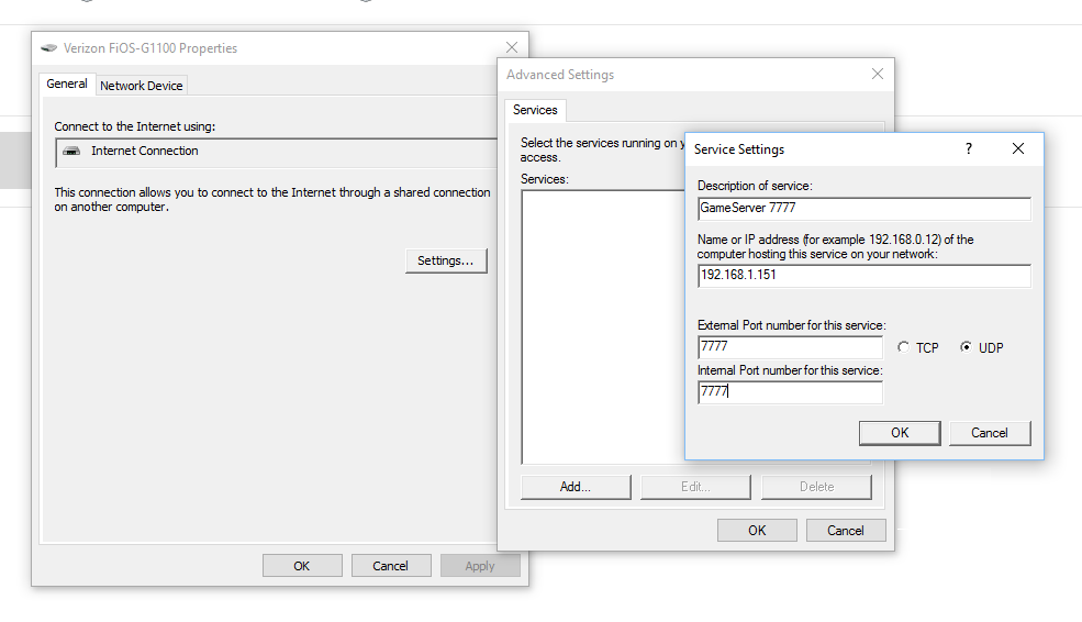

My G1100 Quantum Router keeps dropping Port Forwarding of UPD port 7777. I'm running a Conan Exiles Server that Requires ports 27015 and 7777 to be opened up. I've setup a Rule that includes both ports and added the computer hosting the server to the router's Port Forwarding list using the rule. Then I have to add them Manually via the router's property sheet because the original steps don't make the server visible to Steam and the Game itself.

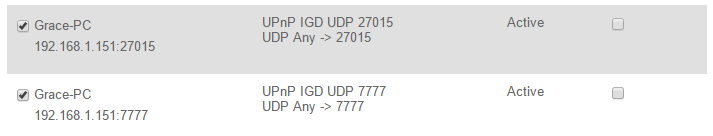

 Once added via the property sheet, they appear in the router Port Forwarding table:
At this point, the server is visible on Steam and in the game until the 7777 port forwarding entry dissapears (which happens every few hours).

This looks to be due to the fact that the method being used is causing UPnP Port Forwarding to occur. UPnP Port Forwards have a time-out period, and such port forwards will stop working if no activity is occurring or if an application does not renew the port forward entries.
Try using a manual port forward instead within the router instead of trying to set it via the device properties within Windows.
