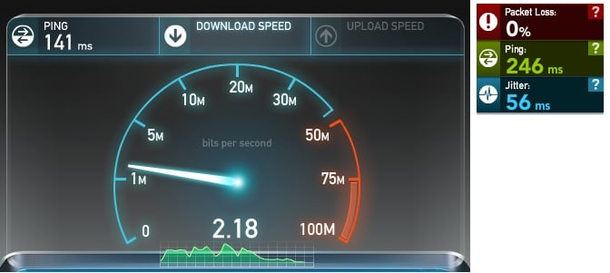

Current speed test results:
The download speed finished at 2.01 but as you can see it jumped around a lot, just like all the previous times I've run the test.
