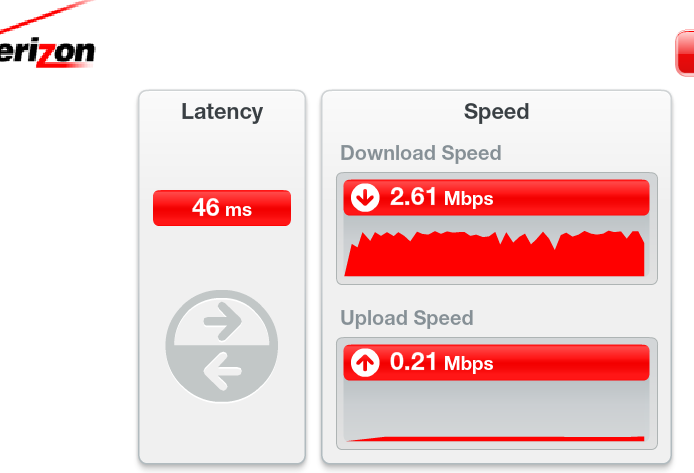

Thanks for responding, and I know this is the community and do appreciate feedback and input.  I apparently didn't put the decimal point in on the upload.  I was getting between .60 and .75 up and now get about .25.  The download speed is fine for dsl and I am not unsatisfied, just trying to find out why I have suddenly dropped to one third for uploads.  The one of my post was in no way intended to be negative to the community, however the phone reps at Verizon support do make it difficult to maintain composure when dealing with them.
Here is the Verizon speedtest result, I will try to run the test you suggested and post the results.

I have a fairly new Modem supplied by Verizon - ActiontecGT784WN.  Sync speeds are:
Downstream 3360 kps
Upstream       290 kps
Using modem for download purposes is fine.  Upload works ok, but has slipped to less than half of what I was used to getting.  Speed tests used to show about .6 to .75, and as I recall sync speeds used to show about 768 when checking modem statistics.  I have made no changes at all to the modem or to any connections, this started spontaneously a few weeks ago.
