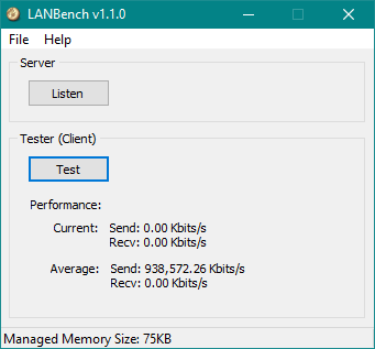

To get that level of speed from my office downstairs up one floor and to the living room on the opposite side of my house, I used a pair of Actiontec ECB6200s that I bought from Amazon. (I have plenty of coax in the walls, but no Ethernet cables.) They use bonded MoCA 2.0 signaling. While I don't quite get gigabit speeds from them I do get:
imageFrom Living Room to Office
in one direction and: imageFrom Office To Living Room
in the other.
in the other.
