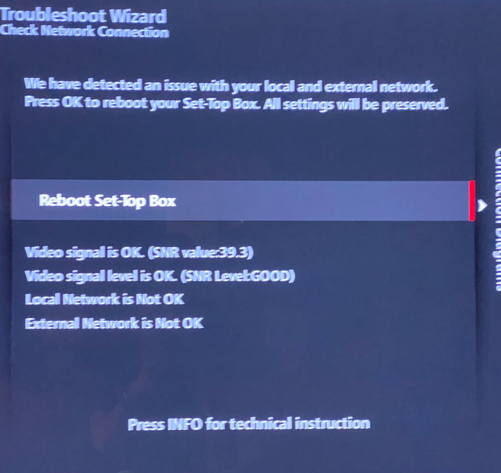

Thanks! So when I go into the troubleshooting menu I get the following message:
 Pressing the INFO button just tells me to reboot everything but that soloution only helps for maybe a few minutes or hours before the connection is hosed again.

Poke around in the menus to find the network diagnostic screen.  I don't remember the exact sequence to get to it, but it's not that hard to find.
Re: G3100 and TV One and TV One Mini
clem21
MVP MVP
MVP
Menu>customer support>top support tools>network diagnostics.

And the diagnostic screen that clem53 and I have mentioned will give you and us information about the quality of the network connections.  If you don't understand what it means, post a picture of it.  If you swap routers, use this screen to determine if anything changes in the coax network.
