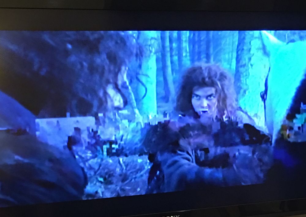

Hello! Everytime we watch something OnDemand (whether paid or not), we are getting super annoying lines / frozen screens (see attached pic).
I've reset everything at least 5 times this week. The TV is also new and this never happens when watching normal TV- only OnDemand.
Any thoughts? Thank you!
Wavy line/previous frozen screen in the middle

I am having the same difficulty. Was able to watch 2 Game of Thrones ON DEMAND but then when I went to watch the third one it was all pixelated and couldn't watch it. VERY annoying. I pay a fortune for services and now I can't view the show!!!
We have also had recurring viewing problems with on-demand video play, usually late at night. Ours are lines across the whole screen like shredded paper along with distorted sound.
