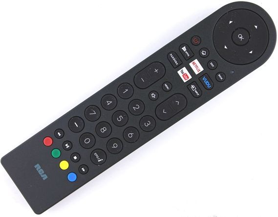

Which of these remotes came with your TV ?
It's manual might lead to your answer.
Hi, I also have this issue. My Remote is not pictured at the site you suggested. Here is the picture. Please help!
