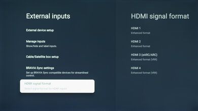

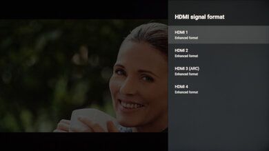

For HDR to work from external devices, the 'Enhanced Format' option usually has to be enabled from the HDMI Signal Format menu for the input you are using. Older devices may have compatibility issues if this option is left enabled, so it is recommended to only enable this setting for devices that require it.

I have the 85" version of that TV and have no issues at all. Sounds like you have the video set to auto in the video options menu on the TV and it isn't playing well with the 2160 output of the Fios box. To be honest the Sony does a better job of upscaling than the Fios box does so you are better off using 1080 from the Fios box unless you are watching 4K content. Are you on a mini or a VMS unit? You could also try going into the service menu on the Fios box, changing the resolution to 2160 30fps, saving that and seeing if it helps. Also if you are on a mini using WiFi, it is known to be unreliable. You might also want to check this, when the Fios box is set to 2160:

Those pictures are kind of hard to see, but they came from the link I posted. If you need help with the Fios Service menu, let me know.

Put the hdmi in a different port and played with the settings and I think I got it to work. Thanks so much!!

Did you go into the port settings and make sure they were set to enhanced? Makes a big difference if the source is trying to send 2160 or HDR to the TV.
