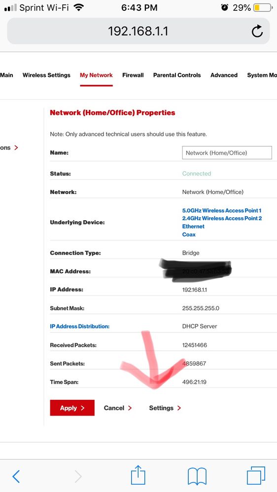

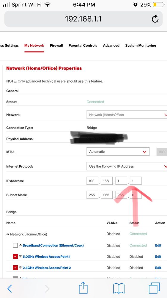

Here are some pictures...
Re: Using a Nighthawk XR 500 router with Verizon Fios tv
Edg1
Super User
Super User
Only would let me do 3 pictures. Here are the rest.
Once on the last one chage 192.168.1.1 to 192.168.2.1 and scroll down and apply. It will tell you to open a new browser. Frome here on to access the G1100 you will have to now type 192.168.2.1 in your browser. Verify you have internet while connected then roboot your STBs and you should be good.
